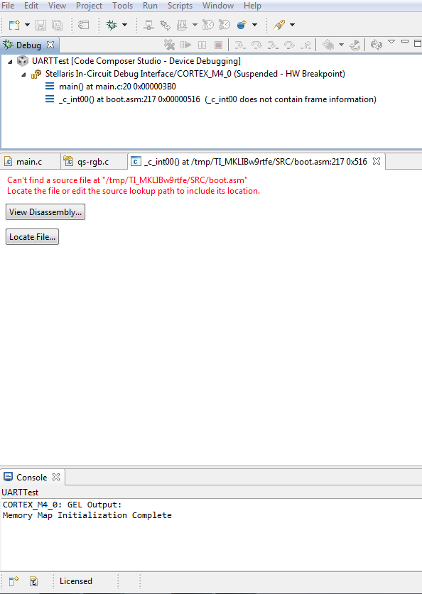

  • One more thing. I debug the program and click resume to start the program on my mikrocontroller. This should be a simple program to test the UART programming. I connect the board via PuTTy, pushed enter but there is nothing shown in the console.
    Here is my actual code:
     * main.c

    Maybe the problem is after debug, it is shown in the picture above.
    Is there any fault in my code why the communication does not work ?
    regards
  • Hello Christian,
    The error message shown in the second pic is OK as you are using the pre compiled version of driverlib.lib.
    On the issue of nothing showing in PuTTy, is the first print of "!" coming? Also is the PuTTy connected on the same COM port as shown in the Device Manager in PC and the Baud Rate same as that what you have set in the TM4C123 device

  • Hello Christian
    There were a lot of compilation errors. I could get some of them sorted, but not all. However a quick check of the errors led to the following
    1. You are using a old version of TivaWare. Please update to 2.1.0-12573 (it is there on the TI web site)
    2. You have defined the GPIO_PA1_U0TX as GPIO_PIN_2 which is not the correct define. The defines must be from the TivaWare pin_map.h file for which the following two defines are required TARGET_IS_TM4C123_RB1 and PART_TM4C123GH6PM. You would need to add it to the compilation flow.
    Also the code that came in does not look like the original code post. The utils driver files require the uartstdio.c and cmdline.c to be linked to the project. The first one was but not the second one.

  • Hello Christian,
    Too many corrections to be made.... Attached the final working project. Please check the content of the project to yours.

  • Hello Christian,
    There were a lot of compilation errors in the beginning (so began a clean up and simplification of the code). Make sure that PuTTy is started before the program execution for "!" is put out. I had the issue so did a reset of the launchpad.
    Anyways, the code has started working for you, so I believe you should be able to play with it to understand more... One way is to send the characters like -1 and see how the CPU stores it to be able to make signed/unsigned decision.

  • Hello Christian
    1. Changed char* input to char input[40];
    2. Changed the while loop
    while(1){
    UARTprintf("\n TM4C !\n");
    UARTprintf("Input please:\n");
    UARTgets(input, sizeof(input));
    UARTprintf("Your input is :%s",input);
    3, And added the startup_ccs.c to your project (file is missing and sadly after a reset w/o this file the project does not work).
    After doing 1-2-3, all is OK
