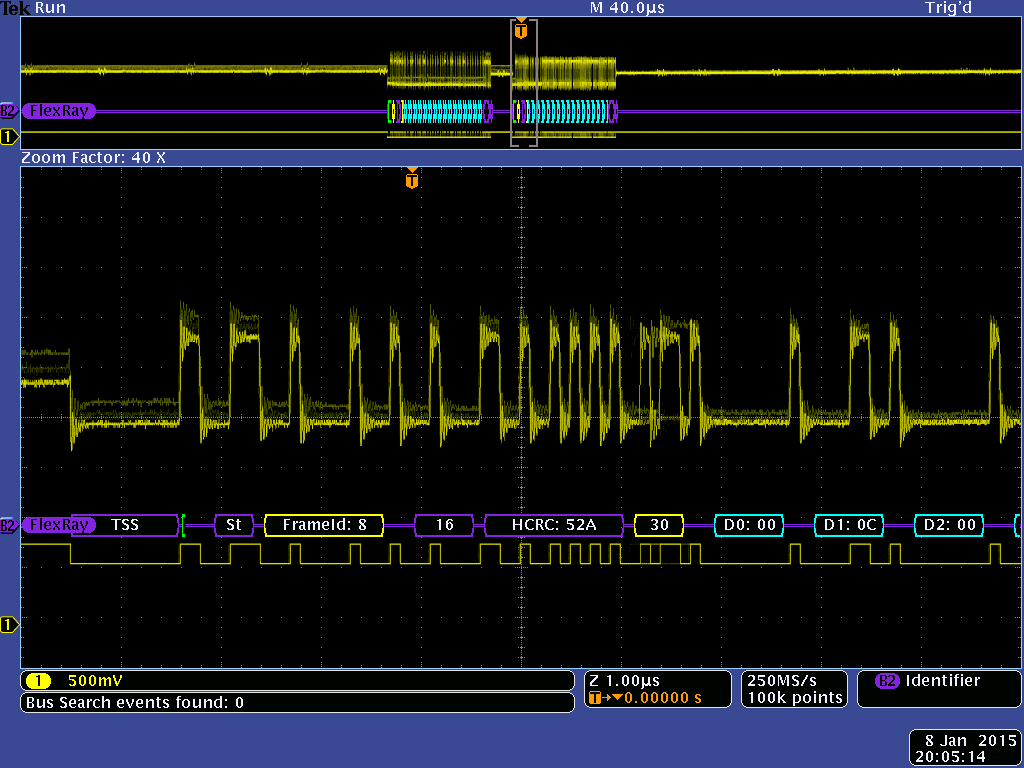

Here's a data capture from an oscilloscope just to show that it really coldstarts:
I would be grateful for any suggestions about what am I missing.
