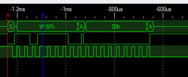

  • Thank you.  As I looked at the code and re-read the documentation I figured this out.
    I have SMBusMasterBlockRead working.  It does a proper turn-around and reads the correct data.
    However, I am having problems with SMBusMasterByteWordRead.  This seems like it should be very simple.    I put a wrapper around ByteWordRead call to wait for the MasterBusIntProcess to signal completion, just as I did for BlockRead.  The address is written, but the line does not turn around.

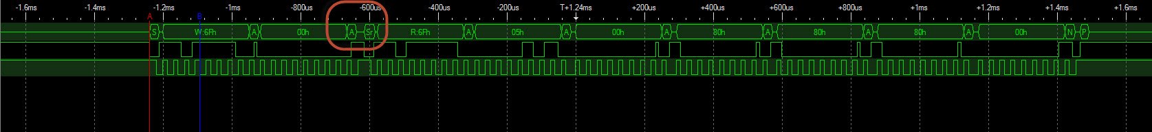

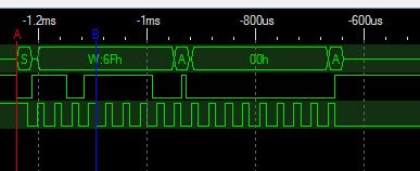

  • Hello Dan,
    In receive mode the last bit must be NAKed by the Master to indicate that the transfer is complete. However (thanks to the waveform) the last bit is ACKed and the master expects more data to be read. Now the ACK bit is in control of the Master and it should have released it. That will depend on what has been passed to "context" structure.
    Amit

    I tried ReadBlock again - it generally behaves as I would expect.  Here is the trace:
    It properly turns the line around.
    I added a queue to record states as it goes through the SMBMasterIntProcess.  I see that it passes through SMBUS_OK 7 times.  That kind of makes sense - one for each data byte moved.
    I am confused as to how to tell when the transaction is complete.  Can I get that from the SMBMasterintProcess?  Or do I have to loop on SMBusStatusGet?
