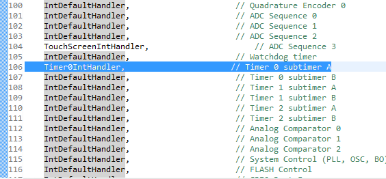

Timer interrupt
There is a problem on blinking the LED by using the timer interrupt with LCD.  Is there anyone can help?  I trying to combine lab 4 and lab 10 of the workshop.

// ******************************** Timer interrupt **************************************
void Timer0IntHandler(void)
// Clear the timer interrupt
TimerIntClear(TIMER0_BASE, TIMER_TIMA_TIMEOUT);
// Read the current state of the GPIO pin and
// write back the opposite state
if(GPIOPinRead(GPIO_PORTF_BASE, GPIO_PIN_2))
GPIOPinWrite(GPIO_PORTF_BASE, GPIO_PIN_1|GPIO_PIN_2|GPIO_PIN_3, 0);
else
GPIOPinWrite(GPIO_PORTF_BASE, GPIO_PIN_2, 4);
Thank you. Appreciate your help.
