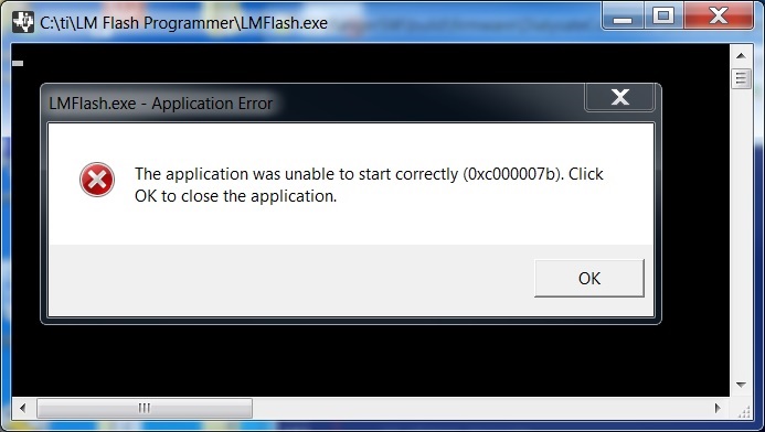

I have not been able to get LM Flash Programmer to run due to what is possibly a DLL issue (error message - application unable to start correctly 0xc000007b).
When the above sflash freeze occurs, I have to take the board to another engineer who does have LM Flash working, so that the jtag reset can be done, otherwise neigher ccs, uniflash or sflash can connect to the board with in infamous "clock" error msg.
I am running this on a Lenovo 64bit windows 7 laptop.   USB cable is the physical transport for the virtual stellaris com port).

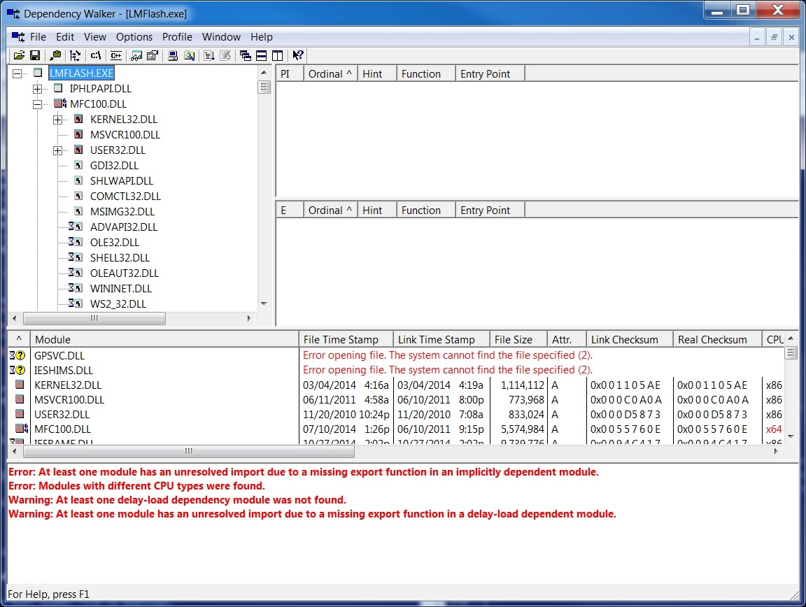

    On the subject of the LM programmer, I was assuming its a missing or wrong DLL because when searching on the internet for the windows error I get, the postings indicated that a DLL issue is usually the cause.  Also I have a tool called "depends" which lists dependencies of an executable and when I ran this tool on lmflash.exe, it reported two DLLs missing.   The tool is obviously wrong since you say sflash.exe requires the same DLLs as LM Programmer because my sflash.exe runs fine.

    I'd still like to get LM Flash Programmer to work.   It works on my engineering manager's machine.  I have the same version he does, the latest.  I've uninstalled and reinstalled.   It just won't run on my machine.  Again the error message is:  LMFLASH.exe Application Error  "The application was unable to start correctly (0xC000007b). Click OK to close the application".
    My machine is Lenovo W540 thinkpad, Windows 7 professional service pack 1, 64 bit, 16Gb ram, Intel i7-4600.
  • Hello Randall
    Which dll is missing? Is that also reported by the tool?
    Amit
  • According to the Dependency Walker tool, it says GPSVC.DLL and IESHIMS.DLL cannot be found.  This is my first time using dependency walker so I cannot say how reliable it is.
  • Hello Randall.
    The walker tool seems to be used quite often.
    IESHIMS.dll is for Internet explorer.
    GPSVC.dll is a system dll and frankly I am not too sure.
    The possible solution is to run a repair in windows to fix the missing dlls.
