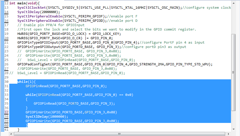

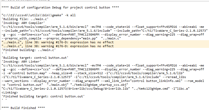

    There is a warning on line #38. I want to write a 1 to PE3 in a while loop. Can help?
  • Hello Jia,
    The expression does not evaluate to a condition. It should be
    while(GPIOPinRead(GPIO_PORTF_BASE,GPIO_PIN_0) == 0x0)
    Amit

  • Hi Amit,
    Is it correct?
    Thank you.

  • Hello Jia,
    To have a simple delay debounce, a solution would be to
    while(GPIOPinRead(GPIO_PORTF_BASE, GPIO_PIN_0) == 0x0);
    SysCtlDelay(10)
    if(GPIOPinRead(GPIO_PORTF_BASE, GPIO_PIN_0) == GPIO_PIN_0)
    GPIOPinWrite(GPIO_PORTD_BASE, GPIO_PIN_3,0x08) ;
    SysCtlDelay(1333333); // Please make sure that this is corrected.
    GPIOPinWrite(GPIO_PORTD_BASE, GPIO_PIN_3,0x00) ;
    Amit
