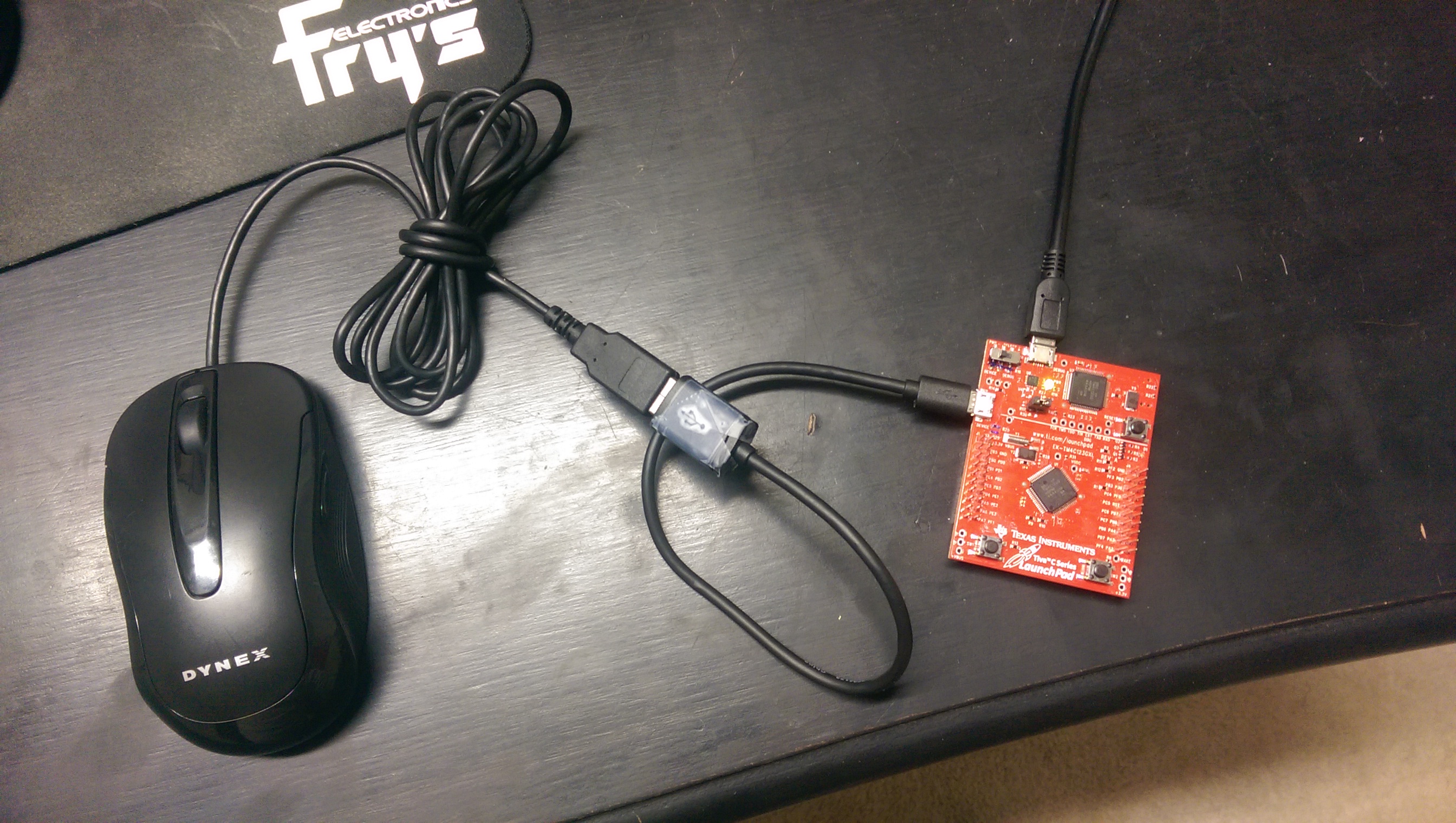

I am working with the EK-TM4C123GXL Tiva C Launchpad trying to prototype a USB host setup. I have started by converting the DK-TM4C123G "usb_host_mouse" example project to use on the EK-TM4C123GXL Launchpad (code given below). I have had a strange bug for many days now that I cannot resolve. When I program the launchpad and execute the device, the code works fine at first. It recognizes a USB HID mouse that I connect, but if I disconnect the USB mouse, the device never again receives a USBHCDEvents() callback for any future USB events. I can reconnect the mouse as many times as I would like, but the mouse is never recognized. If I reprogram the device and re-run the code, the device again will recognize the mouse when I first connect it, but never again.
I suspect the mouse disconnect event is not being handled properly, but I cannot identify the cause of this problem. Please help!
John
