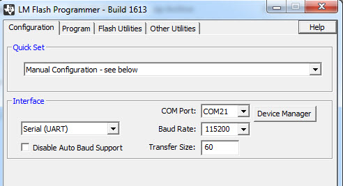

I use LMFlash.exe build 1613 to program a TM4C1231 microcontroller though the UART port.  I connect to the UART through a custom USB-to-serial adapter based on a FT232 chip from FTDI.
I noticed that when first attempting to program the flash memory of the microcontroller, I always get an "**ERROR** Failed to synchronize baud rate with the board!".  If I open the COM port with another software (Realterm) and then close it, After that LMflash can sync with the TM4C1231.  Enabling or disabling auto baud does not solve anything.  On a first attempt to program, It will not synchronize unless I open/close the port with Realterm before.

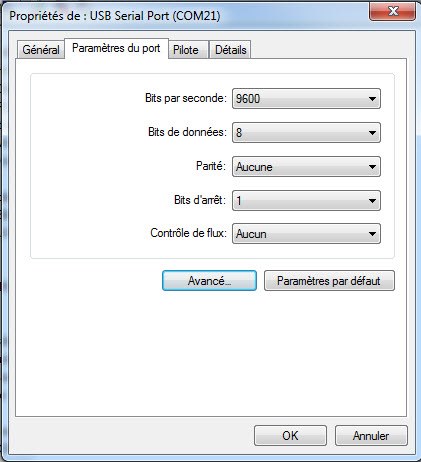

    Not sure if you mean the settings within Flash Programmer or within my device manager... Here is a snapshot of both.
    My OS is in french but basically this is default windows settings
    baud: 9600, Parity: None, Stop bit: 1, Control Flux: None
    When programming with Labview or LMFlash, I will open the port and set the settings to Baud rate: 115200, Parity: None, Stop bit: 1, Control Flux: None just like it is in LMFlash settings. I am able to program with LMFlash after an open/close of the COM with Realterm. And I am able to program the TM4C with Labview using the LMFlash.exe command line interface after I was able to sucessfully program it once with the GUI LMFlash.
