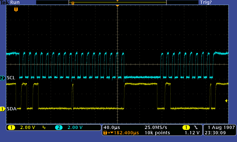

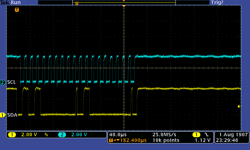

I am communicating with an I2C peripheral using an EK-TM4C1294XL. I modified the existing I2C example. The peripheral understands the following protocol: START [address] ACK [reg addr] ACK [reg val] ACK STOP, where the ACKs are generated by the peripheral, and the rest by the Tiva master.
I observe two different scenarios intermittently - proper and erroneous, and I am not able to understand why the erroneous scenario occurs.
Here is my code in main() (excuse formatting):

Here are the two different pictures I get without any apparent cause for why one is received rather than the other:
In the first case, the first data byte (reg addr) is nowhere to be seen! In the second scenario, I can verify that the transfer is complete and the peripheral responds properly, but why the delay between the 2-nd and 3-rd data bytes?
