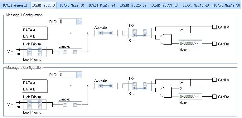

Hercules TMS570LS20216SZWT ,how to set its DCAN for Loop Back Mode?
Other Parts Discussed in Thread: HALCOGEN
hi,
    I want to use DCAN1 module, and set it to Loop Back Mode, Message box1 is for sending data and Message box2 is for receiving data,
but it can not receive data, canIsRxMessageArrived() always return 0.
I have a question at CANRAM init code :
 SYS_Ptr->MINITGCR_UN.MINITGCR_UL = 0xA;
SYS_Ptr->MSINENA_UL = MEM_CH_DCANRAM;
while(SYS_Ptr->MINISTAT_UL == 0);
SYS_Ptr->MINITGCR_UN.MINITGCR_UL = 0x5;
what is the macro MEM_CH_DCANRAM 's  value ? I can't find in datasheet.

  • Weitao,
    I do not think that HALCogen generated code enables internal loopback. You need to set the LBabck bit in the test register (0x14) after calling canInit() function.
    Thanks and regards,
    Zhaohong
  • Hi Weitao,
    I just used this feature on RM48 a few days ago.
    There is an API in HALCoGen to do this:
    void   canEnableloopback(canBASE_t *node, canloopBackType_t Loopbacktype);
    void   canDisableloopback(canBASE_t *node);
    Loopbacktype is defined as:
    typedef enum canloopBackType
        Internal_Lbk = 0x00000010U,
        External_Lbk = 0x00000100U,
    	Internal_Silent_Lbk = 0x00000018U
    } canloopBackType_t;
    You can find this in the can.h and can.c files generated by HALCoGen.
    Christian
