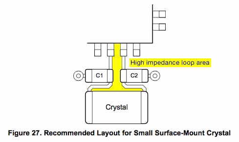

    Surprisingly, the weakest part of USB communication around noise immunity is the pierce crystal OSC on the USB MCUs. The high-impedance loop across the crystal catches noise "efficiently". Even if the MCU core would look like to run flawlessly, USB could fail. USB encoder/decoder are much more sensitive to extra-/missing- clock timing than MCU core.
    It is known by the extreme cases, bread boarding, like this post.
    Just by taking care of the layout of the crystal (and associated two capacitors), MCUs should exchange USB communication without any problem, even on a bread board.
    As of the layout of the crystal, minimize/collapse the loop area enclosed by OSC0 pin - Xtal - OSC1 pin. TI gives good example for TM4C MCUs.
    3.7.2 Crystal Oscillator Circuit Layout
    When you would have doubt on noise immunity of your board, temporarily replace the crystal with an external OSC chip of the same frequency, and set the Main OSC to the no-crystal mode (MOSCCTL.NOXTAL). If this temporary treatment would solve the problem of USB, your board should require revision around crystal layout. Or, replacement to an external OSC, under heavy noise environment.

  • Tsuneo,
    Excellent post!
    Indeed crystal layout is very important matter for any design and the fact that it's especially important for USB controller (thanks for sharing your finding) may not be unique to TM4C MCUs, from my experience.
    As the oscillator is not the only point of concern here, the other vendors provides dedicated application note addressing all hardware specifics of USB with more details. For instance http://www.silabs.com/Support%20Documents/TechnicalDocs/AN0046.pdf .
    It's a pity that for TM4C the only related documents are the design guidelines that provides just a bare minimum information (as usual, unfortunately). Let's ask TI when the similar document for Tiva-C MCUs will be available.
    Moreover, the USB controller implementation in Tiva-C does not look convenient. The MOSC is actually the only clock source for USB and that fact creates a problem as the MOSC (a power-hungry unit) can't be disabled for suspended mode. So each interested user have to invent, to try and to debug his/her own workaround and this is another reason for TI to come up with the AN discussing the "reference workaround". And yet another reason for the USB AN document is the fact that for Tm4C129x, very few documentation for the USB controller is provided. All is under NDA :(
