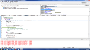

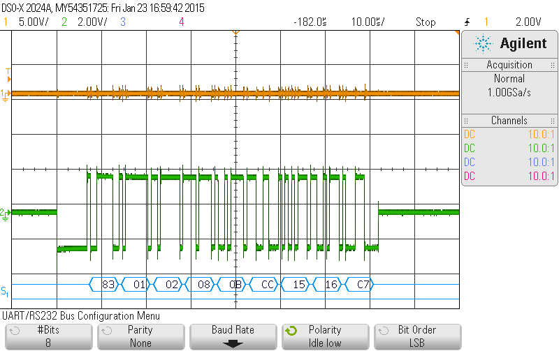

I'm implementing a reception of RS485 datagrams. The datagrams are of fixed length (9 bytes). They are received via SCI and copied to a receive buffer via DMA (block transfer). I'm observing that from time to time bytes get lost. This means sometimes only 8 bytes may get received. Since DMA always copies 9 bytes the reception gets out of sync then and DMA starts copying bytes of the next datagram. With aid of an oscilloscope I could verify that in case of a missing byte the RS485 signal was okay: the datagram on the RS485 line was complete and the signal was not noisy. The position of missing bytes is accidental. The drive enable signal for the transceiver is okay, so no bytes are cut (Rx signal was also verified).
The application is reduced to the minimum for debugging: the main task runs at only 500 Hz and there are no time consuming calculations. Nevertheless, I can observe SCI overrun interrupts from time to time. But they don't seem to be related to the cases when bytes get lost. I tried to cancel DMA and realize a pure interrupt based reception for debugging purpose. But then I got a lot of overun interrupts since the baudrate is high (1.406 MHz).
Please find attached sciInit() and dmaInit() as well as two screenshots. The screenshots show a correct datagram on the RS485 line taken with an oscilloscope and the content of the receive buffer (g_bufferedDatagram) where one byte (0x0b) is missing and the last byte 0x83 is the header of the next datagram.
Do you have any idea what the reason for this issue could be?
Thank you
