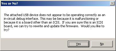

    I performed the following test on an EK-TM4C123GXL which has a TM4C123GH6PM as both the ICDI and target devices:
    1) With the USB connected to the Debug connector used LM Flash Programmer build 1613 to erase the target flash.
    2) Move the USB to the Device connector. Windows then detected as "Stellaris Device Firmware Upgrade" connected since the target flash is empty.
    3) Press the ICDI Firmware Update button on LM Flash Programmer and then get following dialog:
    Selected "Yes" and the ICDI firmware was loaded into the blank target device.
    If the Update button is pressed a second time get a dialog saying the ICDI firmware in the target device is already up to date, and so the programming of the ICDI firmware into the target device was successful.
    4) Move the USB connection back to the Debug connector. LM Flash Programmer was then used to upload the contents of the copy of the ICDI firmware in the target device to a 256 Kbyte .bin file on the PC.
    So, yes it is possible to use LM Flash Programmer to make a copy of the ICDI firmware which could be loaded in your own board.
    However, you would need to check if the TI license allows you to copy the ICDI firmware in such a way.

  • Thanks Chester Gillon for your kind reply.
    I have tried the same thing but its not working. When the target flash is empty it is getting detected as "Stellaris Device Firmware Upgrade" and as I click on ICDI Firmware Update button on LM Flash Programmer i am getting the following dialog:
    I have tried with LM Flash programmer version number 1470 and 1588.
  • Try version 1613!!! It can be found on the ti.com.
    I was able to restore my Launcpad. It work!!! With the old version 15?? I received the same error!!
    Вut the version 1613 helped me! :)
