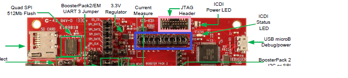

1. page 8 :The on-board ICDI can also be used to debug external boards using the ARM standard 20-pin connector (J1) and pulling all the shunts from J3.
   it means i use flat cable to connect the Tm4c129x develop board and our target .Pulling all the shunts from J3? every pin in J3?
   how did the ccs tool distinguish which cpu,Ev board or our target, i want to debug ?
2. in this mode we call debug out?
3. what is your suggestion for debug in our target ?  standard  ARM  jtag(what model ?) or on board ICDI or EK-TM4C123GXL  if i want to use LMFLASH to        program.

  • Hello Alex
    Yes, that is called debug out and you would need to remove every shunt pin out (UART exempted unless you need COM port function). From the CCS tool it only needs to know the emulator (ICDI) and target (end device). It does not look at any other signals except the JTAG,
    Also you would need to use a 20-pin ARM Header as the documentation mentions

  • Hello Alex
    I don't have a picture but, for debug out, there are the jumpers (shown in blue) that need to be removed. Then you can use the JTAG header (shown in pink) to connect to your board. I had done it with plain wires (but did not take a pic)
    Amit

    according to your explanation , i make the debug out mode list step as follow
    1. use ARM jtag flat cable to connect J1 and my target.
    2. remove all J3 jumper
    3. shunt  TMS(J3.4 to J1.2 ) ,TCK(J3.6 to J1.4 ),TDO(J3.8 to J1.6),TDI(J3.10 to J1.8 ),RST(J3.12 to J1.10 ),UTX(J3.14 to J1.14 ),URT(J3.16 to J1.16 )
         except the 7 pins ,what pins i need to shunt ? do i need to shunt (J3.2 to J1.1)? J1(3,5,11,13,15,17) to ground?
    best regards
    alex wang
  • Hello Alex
    J3 and J1 are already connected. So you do not need to shunt the pins. The ARM Jtag cable can be connected to the target and the DK is ready to work as debugger (though a pretty costly one).
    The other side of J3 is not going to be connected so it is OK to keep it floating (the internal pull of the TM4C129 would take care of some protection.
    Amit
