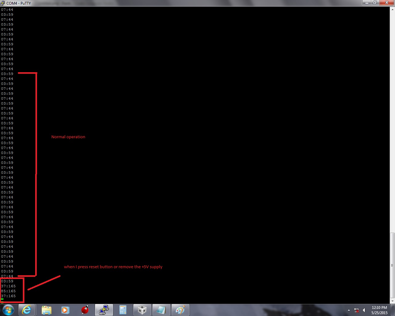

  • Hello Amit,

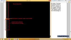

    I press the reset button on the TIVA C Launchpad or turn OFF and ON the 5V Power supply of DS1307.

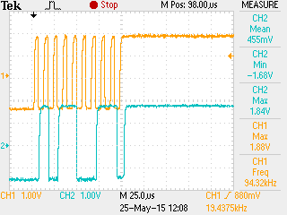

    I have observed the sometimes clock and data pulses are coming (observed on scope) but values doesn't get updated on PuTTy.
    When I press the reset button on Launchpad it shows value of 00:00 and stays there then if I tweak the connections it will update few values and stops again.

    To me it looks like that the RTC IC is not completing an existing transaction and hanging. Does the same happen with power disconnect as well? Did you check the RTC IC's power on specification?
    Amit
  • Hello Amit,
    Thank you for prompt reply.
    Yes, when I disconnect the IC supply it hangs. I'll post after verifying the IC power spec.
  • Hello Amit,
    I have verified the spec sheet, didn't find anything that I am missing.
    I have soldered the crystal at the closest and commented the
    I2CMasterControl(I2C0_BASE, I2C_MASTER_CMD_BURST_SEND_FINISH);
    line in while loop and the code started working. Now when I press reset button on Launchpad it hangs to 00:00 and after tweaking or pressing any connection it starts to count.
    In case 2 when I turn off the +5V supply of DS1307 (Launchpad is still powered up) it hangs on 37:165 .
    Please let me know if I should check something to find the issue.
    Thank you once again.
