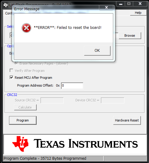

Dear everyone.
we are changed Stellaris(LM3S Series) to Tiva(TM4C1231)
i have question is LMFlashProgrammer.
mass production schedule is close.
we evaluated LMFlashProgrammer, but output an error message.
error message did not come out when written in LM3S + LMFlashProgrammer in the past.
Where it was changed to TM4C1231, now error message is output.
when Error message is output in mass production line,
want measures so ends up being judged as manufacturing defects.
-LMFlashProgrammer is look like finish.
 Software I seem to complete operation.
 but checkbox is set to reset.
 In fact it appears to have been reset, but whether this is really guaranteed to have been reset?
 If reset is guaranteed, why error message is outputted?
 Device side is call to API,
   ROM_UpdateUART();
its waiting to connect LMFlashProgrammer.
LMFlashProgrammer setting is "Reset MCU After Program" checkbox is ON.
please any advice.
