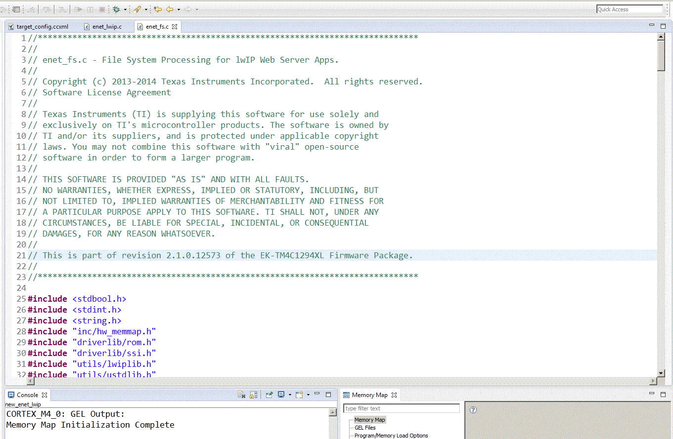

Hi all,
My project starts from enet_lwip, and it works fine so far.
I don't need a webpage, but since the example comes with one, I will just keep it but I want to change the basic home page to point to my company products instead of TiVa line.
In enet_lwip, the index.html is under the fs folder, but when I change the index.html, it has no effect on the .hex, it still uses the TiVa page. Obviously, fs is not included in the build, enet_lwip simply links to the .obj created previously.
So, what do I need to do so that I can have my own simple webpage?
Thanks!
  • Hello David
    There is an application in tools called makefsfile. You need to keep all the files together in a single folder and then use the utility to compile the folder to a header file that can be used
    Amit

  • A few extra steps for future reference:
    1) Add a file called rebuildfs.bat to the project, with the following content:
    C:\ti\TivaWare_C_Series-2.1.0.12573\tools\bin\makefsfile -i C:\Users\MyName\workspace_v6_0\enet_lwip\fs -o C:\Users\MyName\workspace_v6_0\enet_lwip\enet_fsdata.h -r -h -q
    , where MyName is the folder that contains the project, enet_lwip is the project name.
    Note: hard path makes the line readable, skipping dependence/makefile so that we don't need to keep track of the web pages when we add images and other pages
    2) In CCS:enet_lwip: Project->Properties->CCS Build->Steps, add the following to Pre-build steps:
    ${ProjDirPath}/rebuild_fs.bat
    From now on, when you build the project, the webpage will be compiled and included automatically.
    Since a lazy path is taken here by inserting the batch file to the pre-build steps directly, it always recompile the web fs folder regardless the status of the web/fs folder, thus rebuilding may take longer time for each build. If the website is stabilized, place the text "REM" in front of the command line in rebuildfs.bat so that it will skip it.

  • As for the hard path, I can easily get rid of the one referring to the project. If a project is imported from the TI example, such as enet_lwip, SW_ROOT can be used to create the path for makefsfile, but if the project is creaed/imported via other methods, I am not sure if SW_ROOT global variable is still good for the makefsfile, so I keep this ONE in hardpath, like it or not
    Anyway, change
    to
    C:\ti\TivaWare_C_Series-2.1.0.12573\tools\bin\makefsfile -i %1\fs -o %1\enet_fsdata.h -r -h -q
    change
    to
    ${ProjDirPath}/rebuild_fs.bat ${ProjDirPath}
