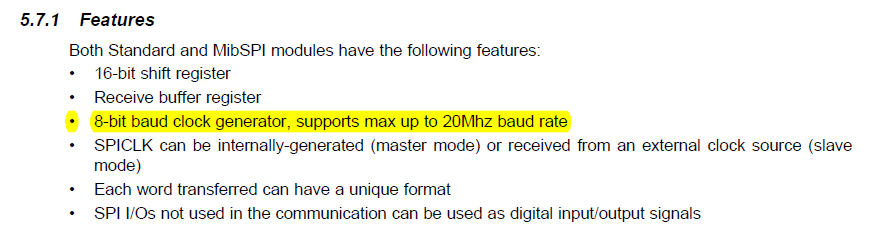

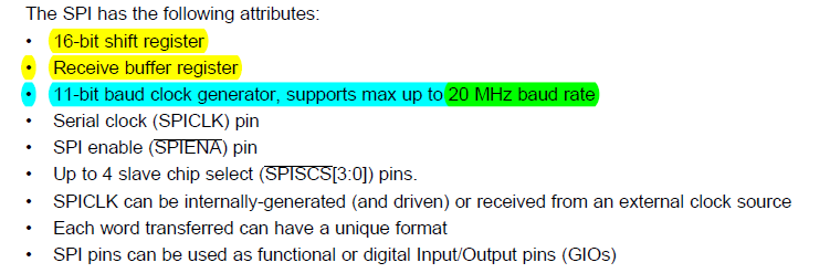

hi ti,
in tms570ls0432 datasheet it s mentioned as 8-bti baud clock generator
in TRM it is mentione as 11- bit baud clock generator. which is correct????
it is also specified that the maximum baud rate is 20MHz.
in timing specifications , SPICLK minimum cycle time is 40ns. hence frequency is 25MHz....
why it s limited to 20MHz.....???
then in registers, if prescale is 0 then SPICLK = VCLK/2 = 40MHz...
which should be used????
  • Hi Pavithra,
    Thanks for pointing out those confused values in TRM and Datasheet. My understanding is:
    1. 8-bit baud clock generator (SPIFMT[15:8])
    2. Supports max up to 20mHz baudrate
    I will forward this question to our TRM/Datasheet owner to confirm. Thanks

  • Hello Pavithra,
    - In regard to the baud rate generator, it is, in fact, an 11-bit baud rate generator. This was an enhancement that was made and is realized through the EXTENDED_PRESCALEx registers. The incorrect information in the description within the datasheet will be updated in the next datasheet update.
    - The 20MHz limit shown in the datasheet and the TRM are not correct and are carryover from a prior device. These limits will be removed from the module descriptions in the next update. You may use the timings within the timing tables as the guides for your SPICLK settings. i.e., 40ns is the minimum cycle time for SPICLK as you have mentioned.
