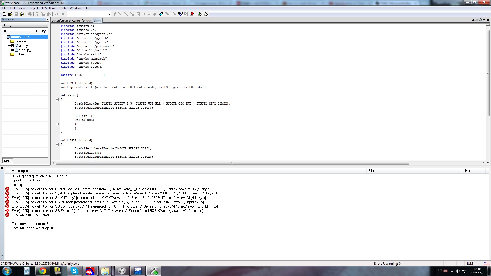

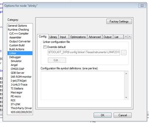

I am trying to implement a code for SPI interface using IAR embedded workbench. When I compile the code with CCS I have no problems - everything  works well.
But when press F7 to compile the code I get these error messages:
And this is the complete code:

I set the include directory in the preprocessors option of the compiler. But the problem is that the functions into ssi.h are only declared but not defined. So may be some link is needed? I don't know.
Any help would be much appreciated.

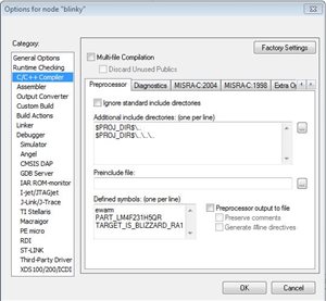

  • We too used that simple, existing "blinky" project as a, "starting point" for a more complex program.
    Suspect this setting - found under: "Project > Options  will resolve:
    We note that you include driver lib's: "gpio.c" - this most always is a bad idea - include of gpio.h should prove sufficient.
    The blinky project is very specialized - was deliberately intended as such - and may not prove "best" as "take off" point for your development...

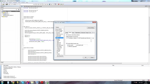

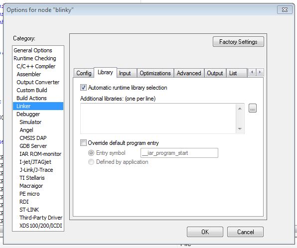

  • Thank you Guys for the advises. Although my problem is different. I don't want to use an existing project because I don't want to modify the example. When I Add existing project I am actually not making a copy of the project. instead I modify the example itself in its very location. Anyway I found a solution on my problem. It was necessary to  specify the library file into the linker (inside the project options). The library file is located at this directory: TivaWare_C_Series2.1.0.12573\driverlib\ewarm\Exe\driverlib.a.
    Loading that file into the linker's library solved the problem.
    I don't find it difficult to create your own project using Tiva Ware libraries. Unlike the CCS, in IAR is pretty simple
    1 Create a new project.
    2 Select your build directory e.g. C:\TI\TivaWare_C_Series-2.1.0.12573
    3 Select your library file into the linker.
    And that's all (in my case).

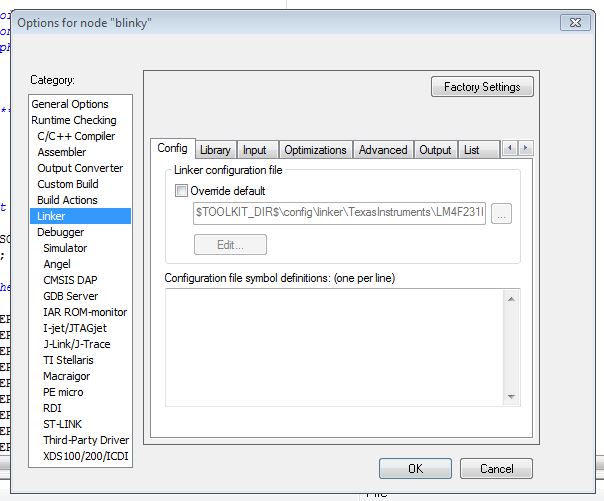

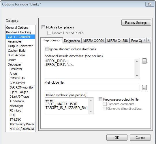

    And why was that?   Look at our settings:
    and
    You'll note that we found NO SUCH NECESSITY to specify the library file into the linker.   Isn't that "special, extra effort specifying" a huge disadvantage - especially when you move to another project - or projects?   (we think so)
    I'm not so sure I'd want to propagate your "methods" - not when more standard and more efficient ones pre-exist...

  • I took time/effort to provide pertinent screen-caps. You acknowledged none.
    Use of "your approach" forces extra effort - each/every project - and I'd bet will reveal "holes/weaknesses" - if not sooner then later...
    your screen caps shows [sic] show nothing.
    Really - you don't actually believe that - do you?
    Do they not reveal - in detail - how IAR should (properly) link to this vendor's driver library?
    While your attempt at psycho-analysis is acknowledged - it (too) is incorrect.
    Screen caps I posted enable our firm to successfully run "much modified blinky" - without resort to the "special" methods you offered up to those (unwary) here...
