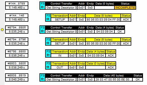

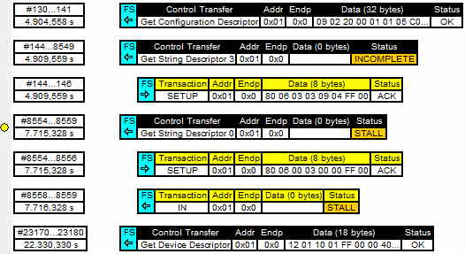

    Just for debug purpose, a "bug" was introduced at the handler of Get_Descriptor( String )
    usbdenum_mod.c
    static void
    USBDEP0StateTx(uint32_t ui32Index)
        // Save the pointer so that it can be passed to the USBEndpointDataPut()
        // function.
        pui8Data = (uint8_t *)g_psDCDInst[0].pui8EP0Data;
    #if 1
    // This section introduces a "bug" intentionally for debug purpose.
    // This "bug" keeps the Control transfer state machine in eUSBStateTx
    // when serial string (3) is requested. This tweak works just once.
    static int debug_just_once = 1;
        tDeviceInfo *psDevice;
        psDevice = g_ppsDevInfo[0];
        if ( (pui8Data == psDevice->ppui8StringDescriptors[3]) && debug_just_once) {
            debug_just_once = 0;
            return;
    #endif
    Here is the bus trace.
    By this "bug", the device stack failed Get_Descriptor( String:3 ), as we intended.
    Also, it failed following Get_Descriptor( String:0 ), too. As the original stack doesn't reset the state variable, the error was carried over to the next Control transfer.
    By adding your fix, the stack beautifully recovers at the next SETUP transaction. The next Control transfer was successfully handled.
