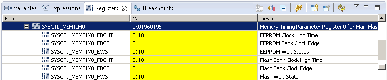

Results in SYSCTL_MEMTIM0 being set to:
i.e. EWS and FWS have been set to 6 wait-states.

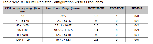

According to Table 5-12. MEMTIM0 Register Configuration versus Frequency in the TM4C1294NCPDT datasheet  DS-TM4C1294NCPDT-15863.2743 SPMS433B dated June 2014 with a 120MHz CPU frequency the optimum value of FWS/EWS is 5 wait-states, not 6 wait-states:
I think this has occurred because the MEMTIM0 Register Configuration versus Frequency table in the datasheet got changed. The revision history for the 15863.2743 revision data sheet says:
Updated table "MEMTIM0 Register Configuration vs. Frequency" with lower wait states, and improved performance values.

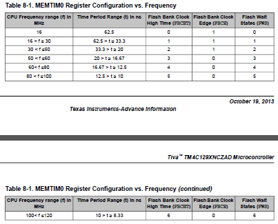

Looking at first issue data sheet DS-TM4C129XNCZAD-SPMS397 from October 2013 shows a FSW/EWS wait-state value of 6 was recommended for a 120MHz CPU frequency:
My question is does the ROM_SysCtlClockFreqSet need to be updated to match the MEMTIM0 Register Configuration versus Frequency table in the latest datasheet dated June 2014?

    The Flash version of the function has a wait state of 5 for 120MHz which is the updated version in the data sheet. However a ROM fix may not be possible as it requires a version change of the device. Unless there is a strong compelling reason to have Rev-4 Silicon this may not be changed and has to be errata'ed out.
