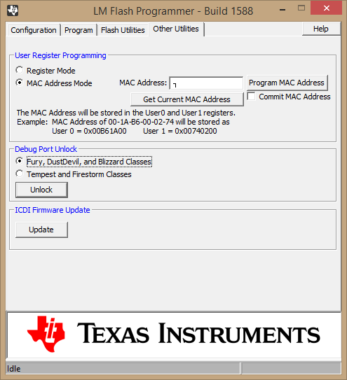

I think I accidentally erased the flash/MAC on my TM4C129XNCZAD Evaluation Board. I opened the LM Flash Programmer 1588 tool and attempted to "Debug Port Unlock" with the "Fury, DustDevil, and Blizzard Classes" option selected, as shown below.

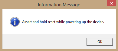

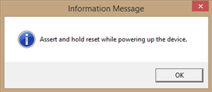

However, as you can see, the MAC Address seems to be lost and won't even discover my device to load changes. As I follow the instructions shown below (aka. I unplug the device from my computer and then plug it into my computer again as I am holding down the reset button).

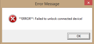

I then recieve the following error message.

    The current version of LMFlashProgrammer is 1613. Did you try a readback of the MAC address using this version of LMFlashProgrammer?

  • I tried it on version 1613. The MAC address does not readback. I am using the TM4C129X, not the TM4C1294...if that matters. But no I do not see a sticker on the back or in the box about the MAC address. Do I absolutely need the MAC address to fix this?
