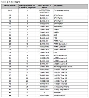

  • Not sure I follow you anymore - you asked specifically about the -16 and that's what I tried to explain - INT_PWM0_1 is defined as 27 in inc/hw_ints.h (it's vector number) but the interrupt number is actually 11 (bit in interrupt registers, tm4c123gh6pm datasheet, table 2-9 on page 104).
    27 - 16 = 11
    Judging from your answer I'm so far off track that I really need to ask you to explain where I took the wrong turn...

  • The numbers listed in inc/hw_ints.h are the interrupt vector numbers. For every non-fault interrupt, ie. interrupts that go through the NVIC, one can get the NVIC interrupt number by subtracting 16 from the interrupt vector number. IntPendSet() "eats" vector numbers, while NVIC_SW_TRIG "eats" interrupt numbers. This is what I've been trying to say all along - is there something else to it? The more I look at this the more clear it seems to me.

    Yet - to provide (proper) clarity - this chart from the MCU manual should prove most useful:
    Note that the "left-most column" reveals (the more usually encountered) "Interrupt Vector Number."
    Next column reveals the less encountered, "Interrupt Number."   Those MCU Registers which handle interrupts - have "awareness" of these "Interrupt Numbers" - and this is the "why/how" of the earlier described, "subtraction of 16" from the "Interrupt Vector's Number."
    Chart above continues on thru Interrupt Vector Number # 154 - and may be used identically...
