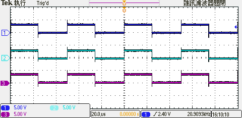

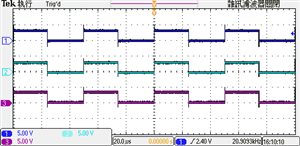

I am learning how to turn on/off clock domain(TMS570LS1227). But when I turn off the VCLK4 by Halcogen, why the ePWM module are working normally.
Also I try to turn off GCLK and HCLK, but CPU are working normally, too. Could you help to clear the question.
1. Turn off VCLK4 on Halcogen.
2. Check the register. Verify the status. (The VCLK4 is turned off.)
3. However, the ePWM module are working normally. why?

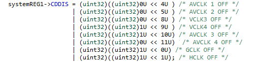

Also,
1. I turn off the GCLK and HCLK, by Handcode. ( We can't trun off GCLK and HCLK by halcogen)
2. Check the register. Verify the status. (The GCLK and HCLK are turned off.)
3. However,  the CPU are normally to work following instruction. (x++)

  • Fan,
    We've been able to reproduce your results, where CDDIS indicates that the disable has been requested but the ePWM still keeps running.
    There is a handshake so writing to CDDIS just requests a power down. If the clocks are in use the peripherals can hold the clock active.
    We're not sure exactly what the reasons are that CDDIS is being held, but in the meantime you can individually shut the clocks off to each e* timers by writing to the PINMMR registers 37,38,39,40. I confirmed that this shuts them off.
