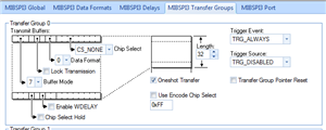

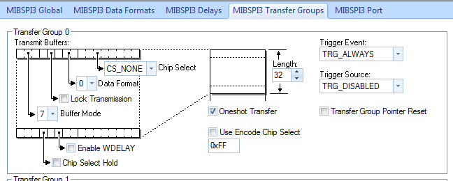

I am trying to use MIBSPI3 as a master to TX and RX. I can currently get it to transfer, but I am not sure how to get the data from MIBSPI RX RAM to DMA to system RAM. I can get the data and see it in the RX RAM using loopback. How to I get the DMA on the RX RAM to trigger? Is it by chaining?
I have been playing with the demo code and looking through the forum, but I haven't been able to make any progress.
Thank you,
Alex
