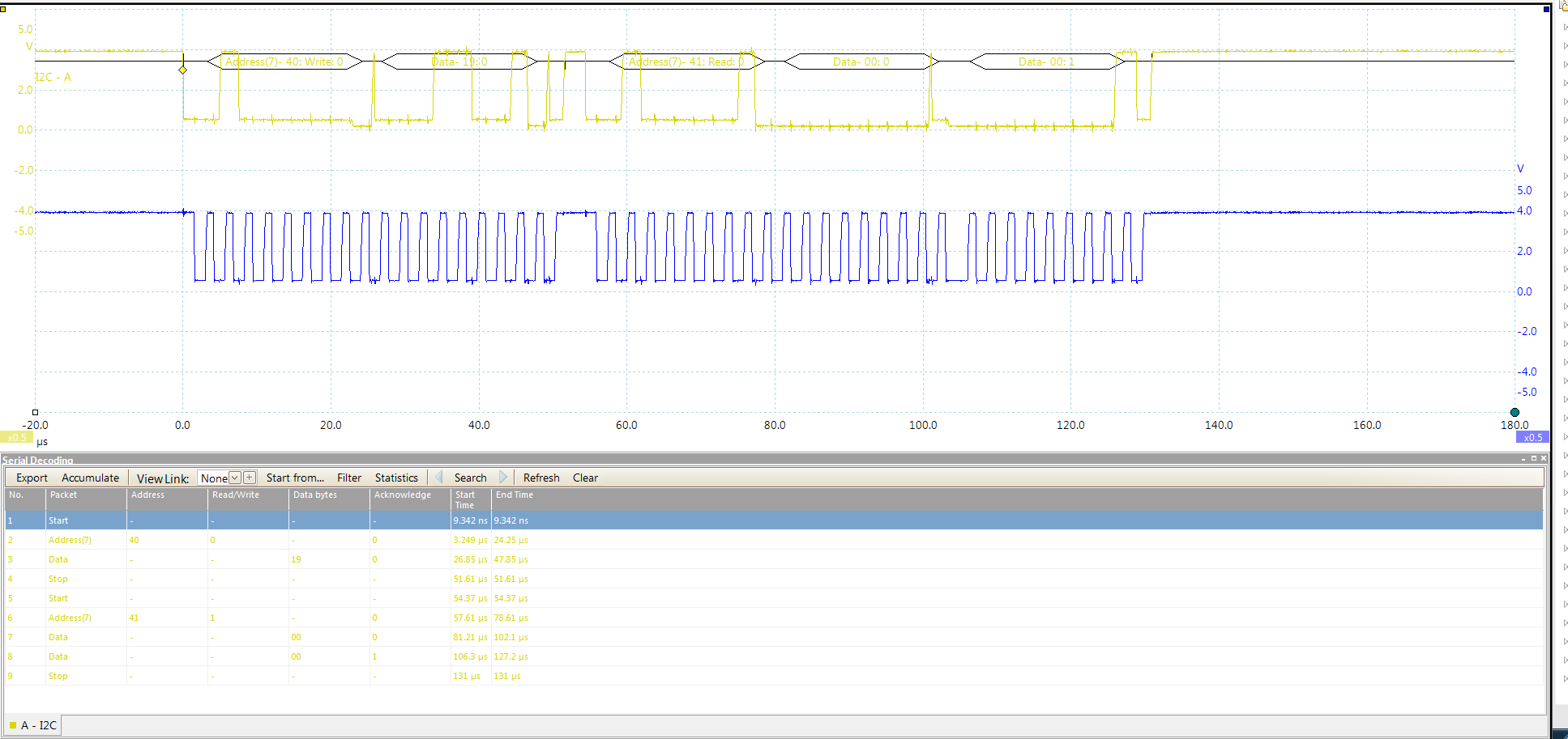

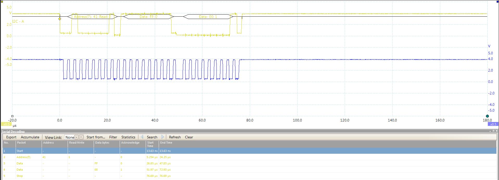

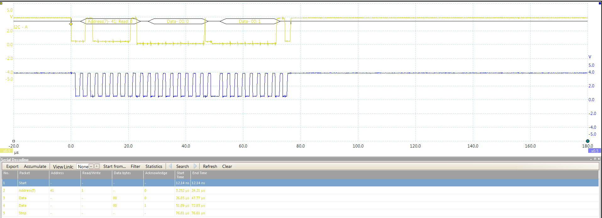

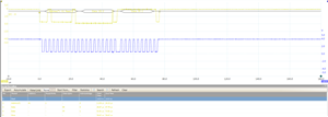

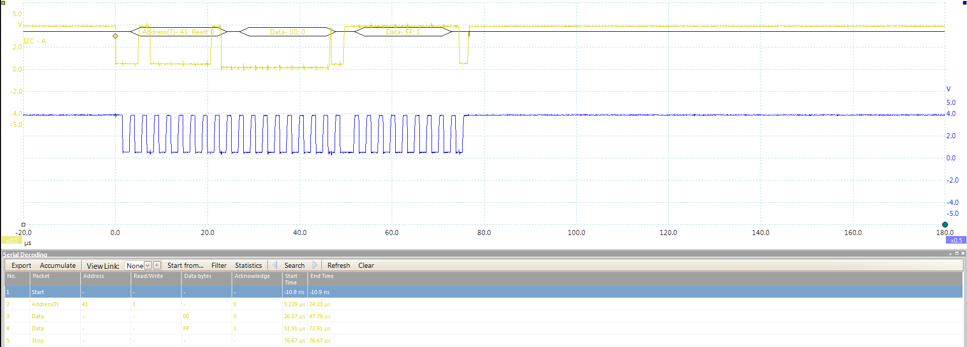

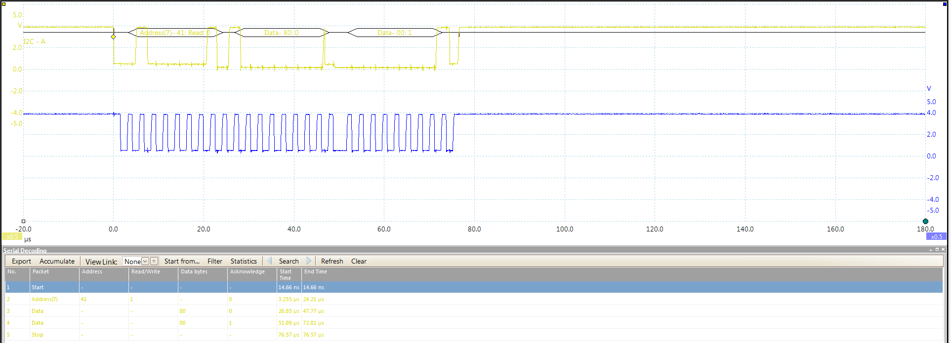

I am trying to interface a Tiva C TM4C1294 (master) with a MCP23017 I/O expander (slave) configured as input. However, I am not reading in the inputs that I want it to but instead I am seeing the following messages on the I2C bus which cycle through the following 5 states roughly 1 seconds apart with all inputs open.
I have copied and pasted my master receive code below. Please let me know what I am doing wrong.

  • No, because I am NOt toggling those inputs. The board is doing that on its own. I have no control of it and I don't know why it does it. The board toggles through all of those states (shown in the pictures above) every 5 seconds.

    I have attached a snapshot of the I2C bus below.
  • Hello Andrew,
    Yes, that looks "almost" correct except that there is a Stop and Start between the two transactions instead of a Repeated Start.
