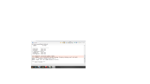

Hi.
I try to make a code that must blink a led, but i receive some errors (see attache.).
This is my code :

  • Hello Dragu,
    Have you defined the compile time define TARGET_IS_TM4C123_RB1?
    Amit

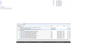

     Code doesn't execute, error are at linker level so no executable was built.
     Which platform are you using OS and target board is the one of title?
     Project is build from scratch or imported as on instruction?
     Are all library and setting of IDE correct?
     DO a copy and paste of error than post a microscopic picture.
  • Oh, you are right, sorry Roberto. I have started many projects in the same time and it looks like i posted wrong. The project Blink a led i have abandoned.
    In this moment  i work at another project. I try to make the same thing what the example project (bitband) make with some small modifications.
    But strange i receive the exactly same errors. It seems that the .obj file is not found. I use Windows 7 OS, and the board is Tiva C Series LaunchPad
    EK-TM4C123GXL.
    Sorry again for my awkwardness.

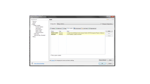

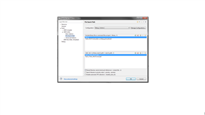

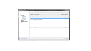

  • Hello Mircea,
    I went through the code and snapshot. I can summarize a few things
    1. If the board is EK-TM4C123 then why is the define TARGET_IS_TM4C123_RA1? It should be TARGET_IS_TM4C123_RB1
    2. The header file inclusion is a must for the compiler to know that the function indeed exists.
    3. Instead of using the SW_ROOT use the absolute path for the include and driverlib.
    4. In the error log snapshot can, you instead take a snapshot of the parameters-options being parsed to the compiler and linker.
