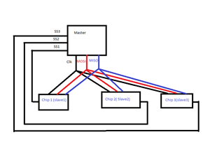

Hello everyone,
I use the EK-TM4C1294XL LaunchPad, I have a question about SPI SSI , it is possible to change the Slave Select pin of an SSI (eg SSI0).
Fares

Hi Amit,
I've another take on poster's (unclear) question.
If he intends to use TM4C as the "Slave" in his SPI system - your answer is correct.
However - there's a good chance that the TM4C operates as the SPI "Master" - and in that case - he may migrate the "Fss pin" to any free GPIO - provided he then manually controls that GPIO - and removes the (original) Fss pin from it's SPI configuration set-up.
[edit] Poster's most recent post just "crossed" w/mine. Still (and spectacularly) unclear - is whether TM4C is a "Slave" or "Master!" Unguided poster's "know" what they seek - but w/out proper steering - a single response thread deteriorates into 6-7 and beyond...
