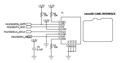

I want to interface SD card with my EK-TM4C123GXL Tiva launchpad. I went through many of the posts on the same, and many of them suggested to start from the Tivaware example of SD card interfacing with the DK-TM4C123GXL launchpad. Taking help from that example, I made a basic code to test of the SD card is present or not as follows:

  • Dear Sir,
    I later understood that error. So, I removed the additional include and modified the mmc-dk-tm4c123g.c according to my launchpad. So, currently, even after the program builds without errors, the output is incorrect. Irrespective of whether the SD card is connected or not, the output is FR_OK, and it does not display any list of files contained in the SD card too. What should I do to make it work correctly?
    The connections on the SD_card are similar to this:
    Just, instead of using Port A, I used Port D definitions (PD0, PD1, PD2, PD3).
    I have attached the modified code herewith.
    Thanking you,
    Moumita

  • Hello Moumita,
    Have you enabled the SSI-1 controller and mapped the entire FatFs to use SSI-1?
    Amit
  • Yes, I have made the port changes in mmc-ek-tm4c123g.c file as shown here:

  • Hello Moumitha,
    Then why is GPIOF being enabled?
    #define SDC_GPIO_SYSCTL_PERIPH SYSCTL_PERIPH_GPIOF
    Amit
  • Hello Amit,
    I changed the initialization to PortD and tried, without any success. Still, irrespective of whether the SD card is connected or not, the output still is "FR_OK". I am attaching the modified code herewith.
    Thanking you,
    Moumita

    I reviewed the code and the following piece of code shows that the PCTL for the SSI Pins is not being configured. Why is that so?
    //GPIOPinConfigure(GPIO_PD2_SSI1RX);
    //GPIOPinConfigure(GPIO_PD3_SSI1TX);
    //GPIOPinConfigure(GPIO_PD0_SSI1CLK);
    Amit

    It was written so in the comments. So we enabled the pins to be SSI and not GPIO. Is this wrong?
    Moumita
  • Hello Moumita,
    The FSS pin is in GPIO mode. However the SSI's other pin of CLK, RX and TX has to be configured in SSI Mode. The PinTypeSSI configures the other settings for the Pin. The PinConfigure function sets the PCTL value for mux selection
    Amit
