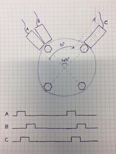

  • If the signal frequency is not high (say, under 10 kHz), the most flexible solution would probably be to use GPIO interrupts and then a software "decoder". You could have a persistent variable that remembers which line triggered last, and deduct the direction of rotation from that. But this comes with a big caveat:
    It doesn't really matter how you decode the signal, with that kind of a waveform you cannot reach a reliable scheme. Just think about it - if for some reason one pulse from either channel goes "missing in action", then the previously described scheme would interpret it as a direction change that would not remedy itself until the next glitch!
    Or consider the following: the rotation stops exactly where channel A is high. When rotation resumes, the next state change - regardless of direction - is that channel A goes low, then B goes high and so on. I could go on, but I hope you get the idea.
    There is a reason to why the quadrature encoders output the kind of signal they do :-)
  • What I'm really trying to say is that I think you should change the actual physical measurement of the signal to be "quadrature compatible".
    The obvious solution would of course be that you move the sensors closer together so that the "high sections" of the signals overlap by approx. 1/2 of their length.
    If this is not possible, you could move the other sensor to detect the next nut, and then position it so that the resulting waveform is the same as suggested above. Assuming that the nuts are evenly spaced, of course.
    Still one caveat: while you could track position & direction with this solution, your speed estimate would be "spiky" - you would get four "ticks" every time a nut goes by, then silence until the next nut comes about.
    If you don't need the resolution, though, you could alleviate this by reacting to just the rising edges on channel A (for example), then use the state of channel B to determine direction.

  • A few notes.
    Agree that a true quadrature signal is to be much preferred.
    This arrangement is similar to that used on some PMAC/BLDC motors. The common solution when they cannot place the sensors close enough to get a quadrature signal from a single mounting point is to use two mounting points The second sensor is mounted so that it detects a different nut (presumably there are several so your 'gear' stay balanced). By varying the position of the second sensor for this second nut you can easily generate a quadrature signal.  There are app notes around showing this usage on gear teeth with proximity sensors IIRC.
    You could also form a ring with alternating high lows sections in an ~50% duty cycle fastened to your nuts to produce a better waveform for quadrature, your signal duty cycle really should be increased.
    An advantage to quadrature encoding over the arrangement you have now is that it allows a form of noise filtering otherwise not available.  There are two issues where edge noise shows up.  One is the transition from on to off and vice versa may have noise. Good implementations will have enough hysteresis to reduce this. The second occurs when the rotation has stopped. If one of the sensors is sitting on an edge then it can jitter back and forth on the edge producing many transitions without moving. This occurs surprisingly easily and worse can have nearly any frequency so it is not easy to filter. Both of these can be eliminated with an A clock B, B clock A filter (you produce and A' signal by setting it to the level of A whenever B makes a transition and similarly for B', these A' and B' are fed to the quadrature rather than A and B).  The issue with this filter is you lose transitions when changing direction.
    Robert
    Exactly what I was trying to say on the first page, but you said it better! Vote #2 for this solution. In any case, I think reaching a reasonable result requires changing the physical arrangement.

  • Hello Robert, Veikko
    Not quite sure on this implementation. Illustration if possible since I can't get a visual picture of the assembly and quadrature signals?
    Amit
  • Here's my attempt to illustrate:
    Note the "ghost" A sensor at a 90 degree offset. Of course the scheme can be applied to other bolt/nut patterns as well. As I said before, this will produce a jumpy/spiky speed signal as you will see 4 transitions in short succession, then silence until the next nut comes by.
    @cb1, absolutely - if a commercial sensor can be mounted then there's no reason to "make your own" - an off-the-shelf sensor will most always be cheaper all things considered. But if you don't have access to the center of the shaft, for example, then mounting a standard sensor might be a pain. For what it's worth, I've used CUI's 203 line (which I believe is very similar to the 103) and found it very nice - but it needs a good mounting location as it doesn't have any internal bearing of it's own. Sticking one at the rear end of a motor is cakewalk, though - that's where they shine. The original poster didn't reveal enough information about his setup to determine whether a commercial sensor could be mounted with ease, but if yes - then all this discussion is indeed moot.

  • Hello Veikko
    Thanks a lot. Now that explains the solution very well and clarifies my doubts too.
