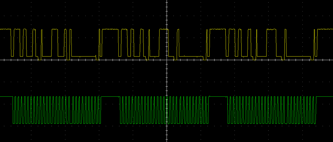

But if check the communication the results show that although the device and register addresses are right, except the register values take the last value for all unsent commands (sorry I don't have a logic analyser at hand, just a lousy scope):
I know it's not much fun decoding this, but I confirm the all the device and register addresses are right, but in all three cases the register value is 0 (which is easy to check).
And if I limit the code to two subsequent writes, then -- again -- the value for both writes will be the value for the last issued command (0x08 in my case).

  • Hello Marton,
    It was a tough read of the scope plot, but it seems that the last 2 transactions are the same (unless you can create 3 snapshots one for each transaction).
    Since I see only a small code snippet, it is tough to say how exactly is the sensorlib State Machine being used!!!
    Amit

  • Hello Marton,
    Clearly the issue is not with the sensor as the Master Is Initiating all the transactions. However a closer look at the code structure tells that
    while(!(I2CMCommand(&g_sI2CM1Inst, ui8Addr, ui8Buffer,
    2, 0, 0, 0, 0, I2CWrite_callback, 0)));
    if the return is false then it will register the same command multiple times and thereby affect the pipe. The only place that it does return false is if the read and write pointers indicate a full message queue. Having said that if you put a delay of say 1000 between the command then does it behave the same way or does it start sending the commands correctly?
    It would be quite some time before I can come to debug this on a LaunchPad+SensorHub.
    Amit
  • Hi Amit,
    Removing the while loop itself alone did not change anything, however adding the delay seems to fix the issue.
    If you do not think it is uncommon to send burst commands the way I did, please consider reviewing the code in the next Tivaware release -- it took me a day of head-scratching until I started to investigate the communication itself.
    Thank you for your quick fix, I am really grateful.

  • Hi Amit,
    In the meanwhile I checked the i2cm_drv.c code and now I see it was not intended to work like this. It just queues pointers to read/write data, so I cannot reuse them until the transaction has been completed. Nevertheless, it is very useful for different devices sharing the same I2C bus.
    Thanks again for your help,
