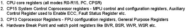

About TMS570ls3137,I met some problem. I want to use stcSelfCheck function. And I read relevance context in TRM. I know make STC execute before main function or on stratup. And I can execute stcSelfCheck function on stratup successfully. But now I need to execute stcSelfCheck periodically, I have to put stcSelfCheck function in the main function. From TRM, I know I need to save some registers, back up before and restore after self-test.DO I have to save all the register in the TRM? BUT in the compiler I cannot see all the register during the running.And when the stcSelfCheck function finished in main, the chip will reset. Then it may reset again and again if the stcSelfCheck function in main?.How can I run stcSelfCheck whenever I want without reset again and again?

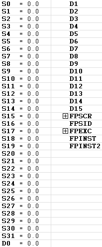

I can find registers which in 1. 2. and 3. but I cannot find registers in 4. IS the break point register and watch point registers in CP14?
