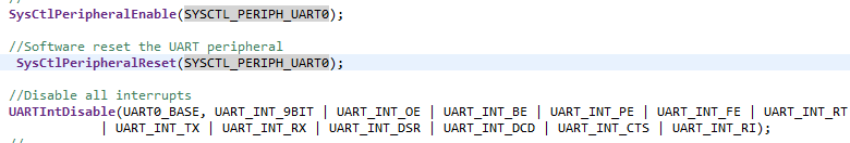

Hi!
The problem:
In the code spi_master.c, characters are printed to the serial console window. Line 167 in the code is shown, line 168 is not shown. With these settings:
// Initialize the UART for console I/O.
UARTStdioConfig(0, 115200, 16000000);
The console is also setup for 115200 bits/s.
Switching baud-rate, what happens?  Its very strange that it cuts straight into a sentence.
What would possible cause this line:  UARTprintf("  Data: 8-bit\n\n");
to not write the " a: 8-bit" ?
Pushing the resetbutton on launchpad, makes the same message appear after each "reset".
Talking with Putty instead?
My friend can run the code on a linux dist, using screen as serial console. Everything works fine. what is this sorcery?
Serial console programs: Putty and Tera term, both show the same error. Using standard: 8 bit data, 0 parity and 1 stop bit.
Platform: TM4C123GXL Launchpad, tiva c series
Program:  Code Composer Studio, Version: 5.5.0.00077
Code:
C:\ti\TivaWare_C_Series-2.1.0.12573\examples\peripherals\ssi using the given example; spi_master.c

  • The only pattern is this regarding baud rates:
    at 230k ~ I get the above
    At 460k ~ slightly more
    then at 900k~ nothing
    at 9k-40k ~ nothing
  • Hello Jerry,
    Did you try connecting the debugger and seeing where the code is looping?
    Amit

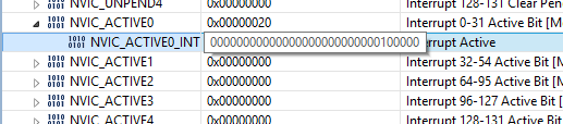

    // This is the code that gets called when the processor receives an unexpected
    // interrupt. This simply enters an infinite loop, preserving the system state
    // for examination by a debugger.
    static void
    IntDefaultHandler(void)
    // Go into an infinite loop.
    while(1)
    My conclusion is that we are at the endpoint of many different errors, none which can be specified?
  • Hello Jerry,
    Then the next step would be to look at the NVIC Pending bits to see what is the interrupt source.

  • According to datasheet this is bit nr 6 and is a Usage Fault, I'm not sure if i am looking at the right place and finding the right info.
  • Hello Jerry
    It is UART0 Interrupt bit. The Exception types 0-15 are not mapped via the NVIC_ACTIVEx registers and hence it is not a usage fault. So it seems that the UART0 Interrupt bits are set and interrupt is enabled w/o having a interrupt routine. I would suggest doing a SysCtlPeripheralReset of the UART and/or making sure that the UARTIM bits are cleared.
    Amit
  • Hi
    thanks, i see now how the NVIC table labels are sorted.
    I tried to first reset and then make sure that all interrupts are disabled, and still the problem prevail. The active interrupt is still nr 5, UART0. I tried having the software reset both before and after enabling the UART0.
    Additional info: The code spi_master.c explicitly states that no interrupts are used, and that no interrupt handlers need to be added to the vector table.
  • Hello Jerry
    Add the reset before the enable to the module is done. The reason why I say so is that on enabling the clock if there is an interrupt bit already set then clocking will allow the interrupt source to propagate. Also please check that after enabling the clock (in the faulty condition) what does the UARTMIS value read as.
