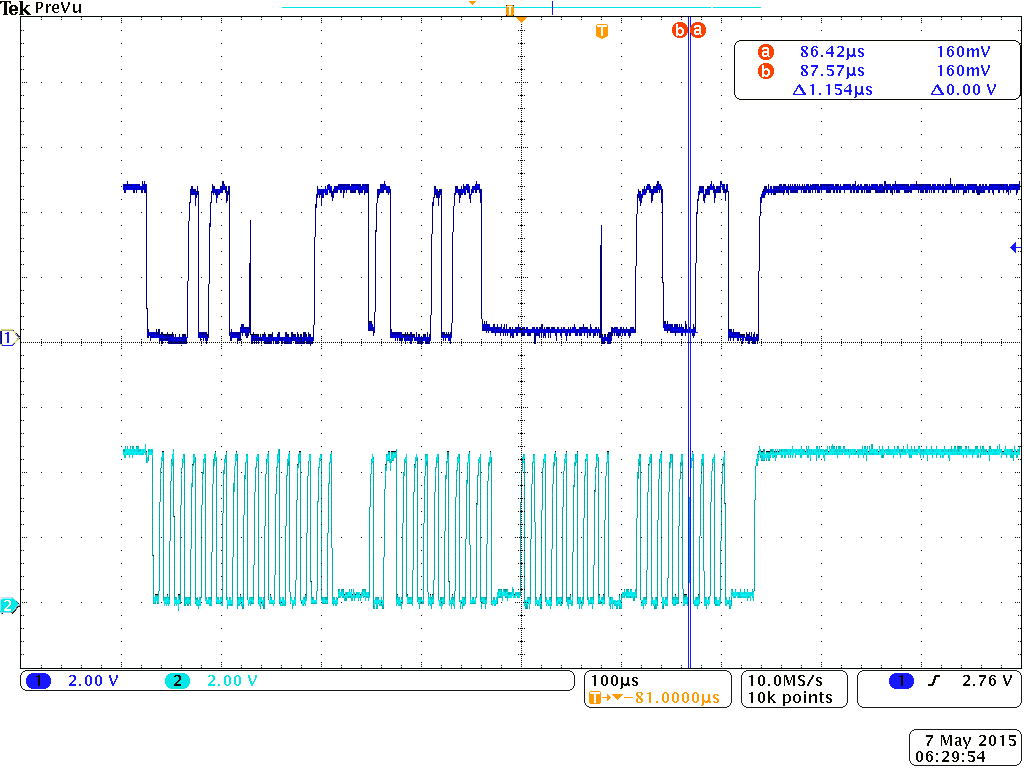

  • I am continuing to get the Bus Busy condition on a new version of the PCB.  "Nothing else changed"
    I am testing by running the same read/write sequence on the bus. I read/modify/write one word register, then read another.  I repeat every 100 ms.   This should not be very demanding.  The system will encounter bus busy within 5 minutes, but probably average more like 100 seconds between failures (1000 cycles, 4000 transactions).
    I had set the glitch filter to 32.  At 100khz, what are the trade-offs.  It seems with 50mhz clock, 32 clocks would be 640ns. Reasonable, but on the long side.   I tried 16 for glitch filter - not much different - perhaps a little more frequent failure.
    I am monitoring the I2C signals with both a scope and logic analyzer. They look pretty good.  We do have some capacitance in the cables out to my battery.  3.3 Ohms to 5V is not strong enough to meet the 1000ns rise time requirement of the spec.  We tried lower values, but start to run into drive current limits by the battery during clock stretching - the hold clock rises to 400mV - still a zero, but losing margins.
     The failure mode I get is Bus Busy. The MCS also reports IDLE and CLKTO are set.  How can it be BUSY and IDLE at the same time?    I also verified on the scope that there was a valid stop when the busy fault occurred.

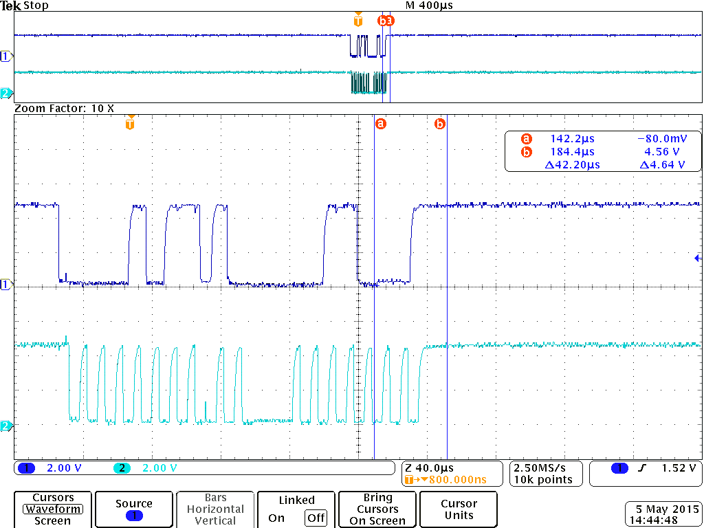

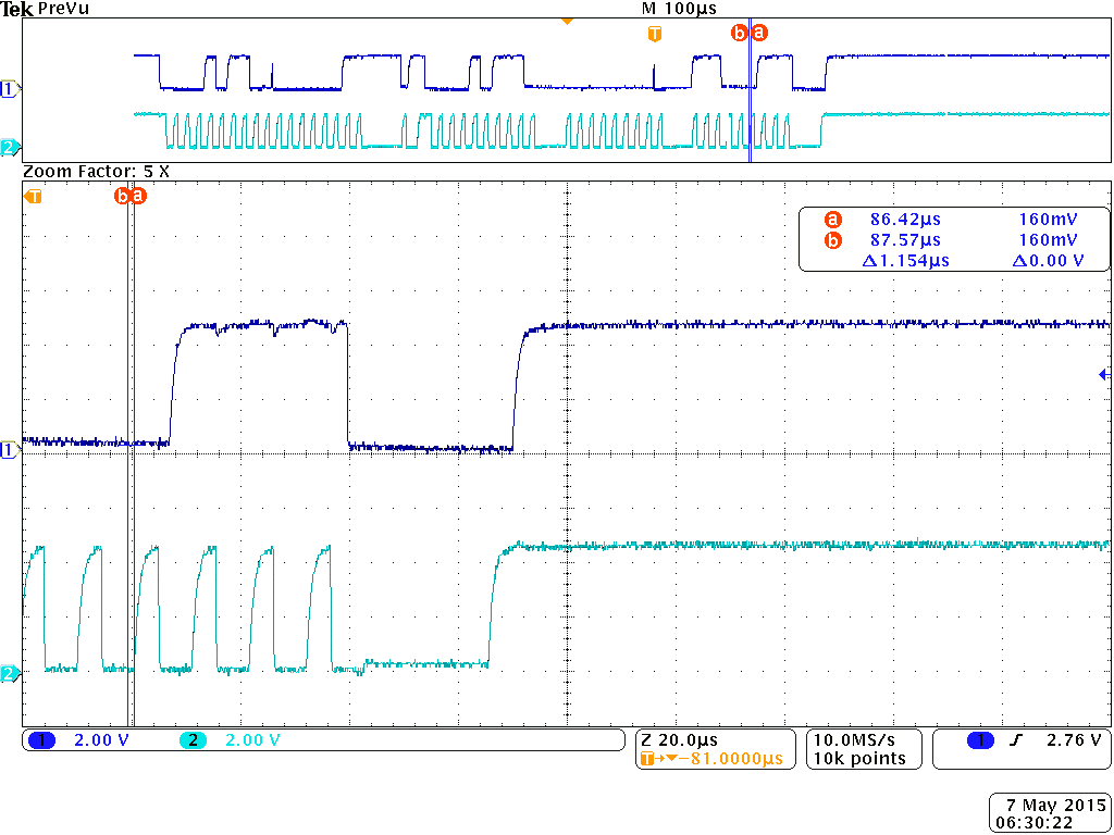

  • I moved the CLKTO out to 40ms and still encounter errors.  Usually CLKTO is not set.   But I still get the bus busy error.
    The error seems to be at the eighth bit of the address.  Notice the runt pulse on 8th clock.  We are sending out 0x16, so there runt is where the 8th clock should clock the lsb 0.  It appears to be stepped on.  The next high is where the ACKn should be.
    We are able to repeat this.  About 1/4 of the failures are caught on the scope (others are after the end of scope capture).  The runt pulses are visible.  Without the bus busy halt,  the runt doesn't appear.
     associated with the 8th bit.
    I am betting that the issue is firmware induced as it happens in the same position.  I am using the TI SMBus driver from the UTILS package.    I dread debugging through library code.  Do you think this is the next step?  Or is there a hardware explanation?

  • Thanks. We don't think that is it. We have a slight ground differential between the master and the slave and can see about 100 mv difference between low caused by the master and the slave. This is well within the input specifications. Since the grounds appear the same before and after the runt, we believe it is the host side.
  • Hello Dan
    The I2C Master does not cause a Runt condition unless it detects a wrong SCL pulse. Now, as I see in the waveform, there are too may runts appearing during the transaction and I would expect to isolate the cause of the runts on the board. Is there a power trace in the proximity of the device which is switching ON and OFF.
    Secondly, the runt may be seen by the Slave as it may not be having sufficient Glitch filtering and if the 50ns glitch suppression is not there as per the spec then slave may well be out of spec. Also can you see with high resolution the width of the pulses to not exceed the 50ns.

    Thank you very much. I found the root cause in my code. The TI part did generate the runt pulse due to invalid sequencing of my code. I found that the timeout for a blocking semaphore was set to only 10ms. The remote slave was holding the clock lines low for its setup. After the timeout, bus busy code reset the peripheral.
    I changed the semaphore timeout to 50 ms - twice the allowed TCLK Hold and the bus errors disappeared.
