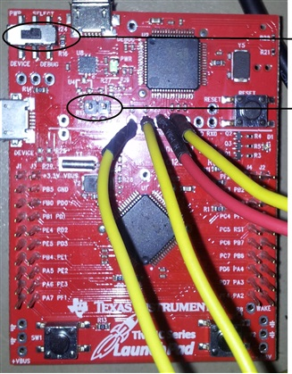

  • Hello Austin,
    More details on using a LaunchPad as a debugger.
    e2e.ti.com/.../408020
    Please note that TDI on the launchpad is to be connected to the TDI of the end device and the same for TDO. Also the UART RX pin on the debugger is RX pin on the end device and same for UART TX.
    Amit
  • Hi Amit, thanks for the quick response. Here are the steps I have taken to program my own board.
    1. Keep the Switch in Debug Mode
    2. Remove the VDD Header
    3. Connect the JTAG Wires
    a. LaunchPad TCK to TCK (PCO)
    b. LaunchPad TMS to TMS (PC1)
    c. LaunchPad TDI to TDI (PC3)
    d. LaunchPad TDO to TDO (PC2)
    4. Connect the UART Wires
    a. LaunchPad TXD to UTX0 (PA1)
    b. LaunchPad RXD to URX0 (PA0)
    5. Connect LaunchPad RESET to RESET (Pin 38 - there is a external 10k pull-up on my board)
    6. Leave LaunchPad EXT DBG unconnected
    7. Connect GND between boards
    8. Open up LM Flash Programmer, select TM4C123G LaunchPad under QuickSet
    9. Select binary file, press Program button.
    10. Receive following error:
    **ERROR**: Unable to initialize target - 0!
    I am unsure what I am doing incorrect. Both boards have power.

  • Hello Austin
    Think this is the issue
    Should be
    c. LaunchPad TDI to TDI (PC2)
    d. LaunchPad TDO to TDO (PC3)
    Amit
  • Hi Amit
    Thanks for all your help. After taking a meter to the board, there were a few issues. First, I was supplying the board with 3.3V, so after the diode going into the on board LDO, the voltage was around 2.4V. I fixed this issue, then additionally correctly wired the JTAG pins and have successfully uploaded my binary file.
