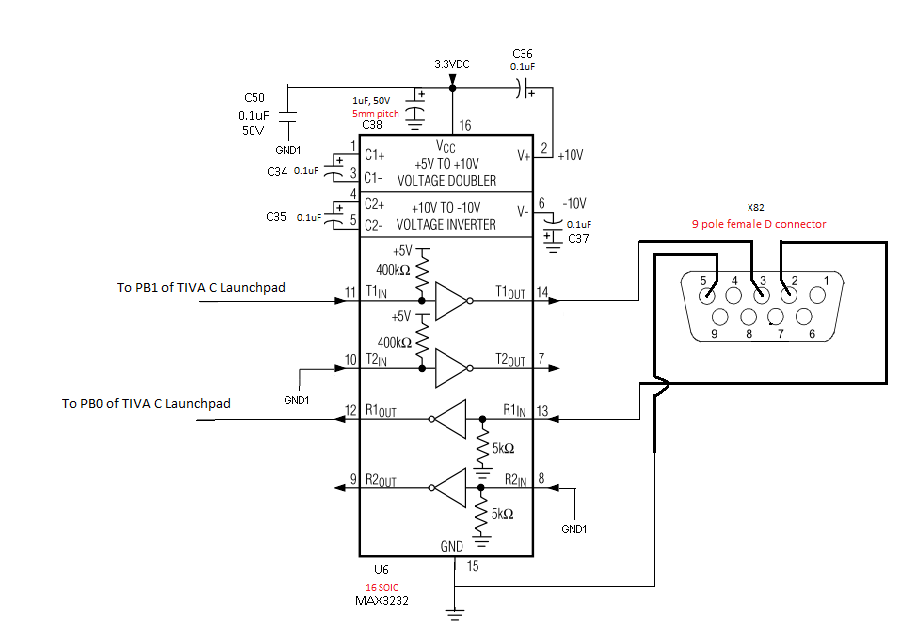

I am using TIVA C Launchpad, TM4C123GH6PM and trying to connect through my PC by RS232 medium. I have modified the UART echo example and configured PORT B (Pin PB0 and PB1) as UART.  Earlier I have checked the same code with PORT A (without RS232) as given in UART Echo example it is working. Below is my h/w schematic. Am I making some mistake in connection..? Please let me know. I have connected Putty to enter text and LED glow, but in case of RS232 nothing displays.
Thank you.
