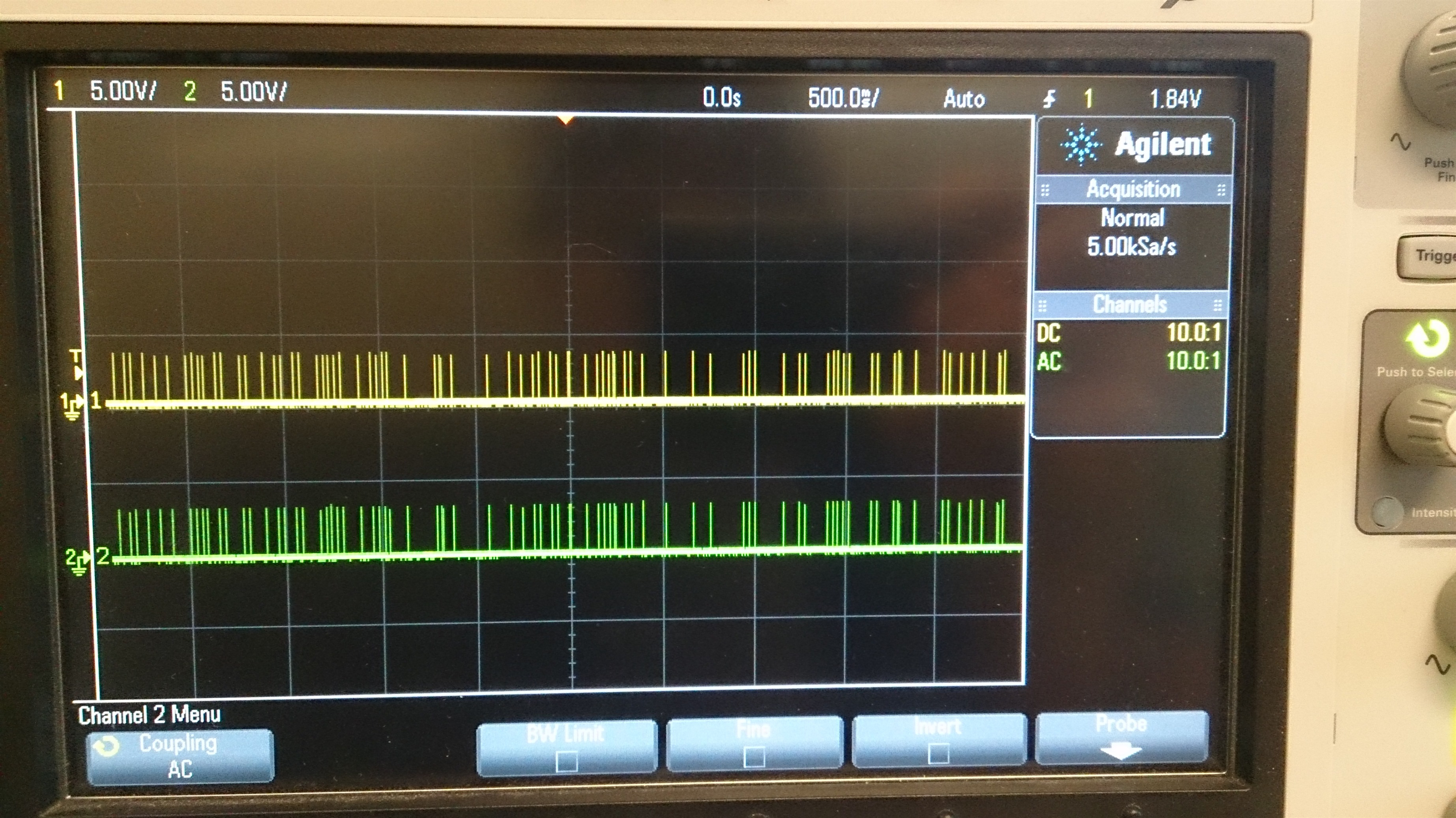

Hi all,
I am using tiva c to toggle a pin on for 100us and turn off via serial input(interrupt by UART input). However, it does not toggle every time when the delay or gap is less than 100us. It works fine for 500us. I am wondering what causes the issue here. I have attached two pictures for you guys to compare.
100us delay
 500us delay
As you can see, when the delay is 100us, it simply skips some pulses while at 500us it generates all the pulses.
Here is my code.

  • Hello Wilfred,
    A lot of code, with no clear meaning to what is being transmitted and received and why is the GPIO toggle so important?
    Simplify: Toggle the GPIO in a while loop with different delays and you will see equal space out.
    Amit
