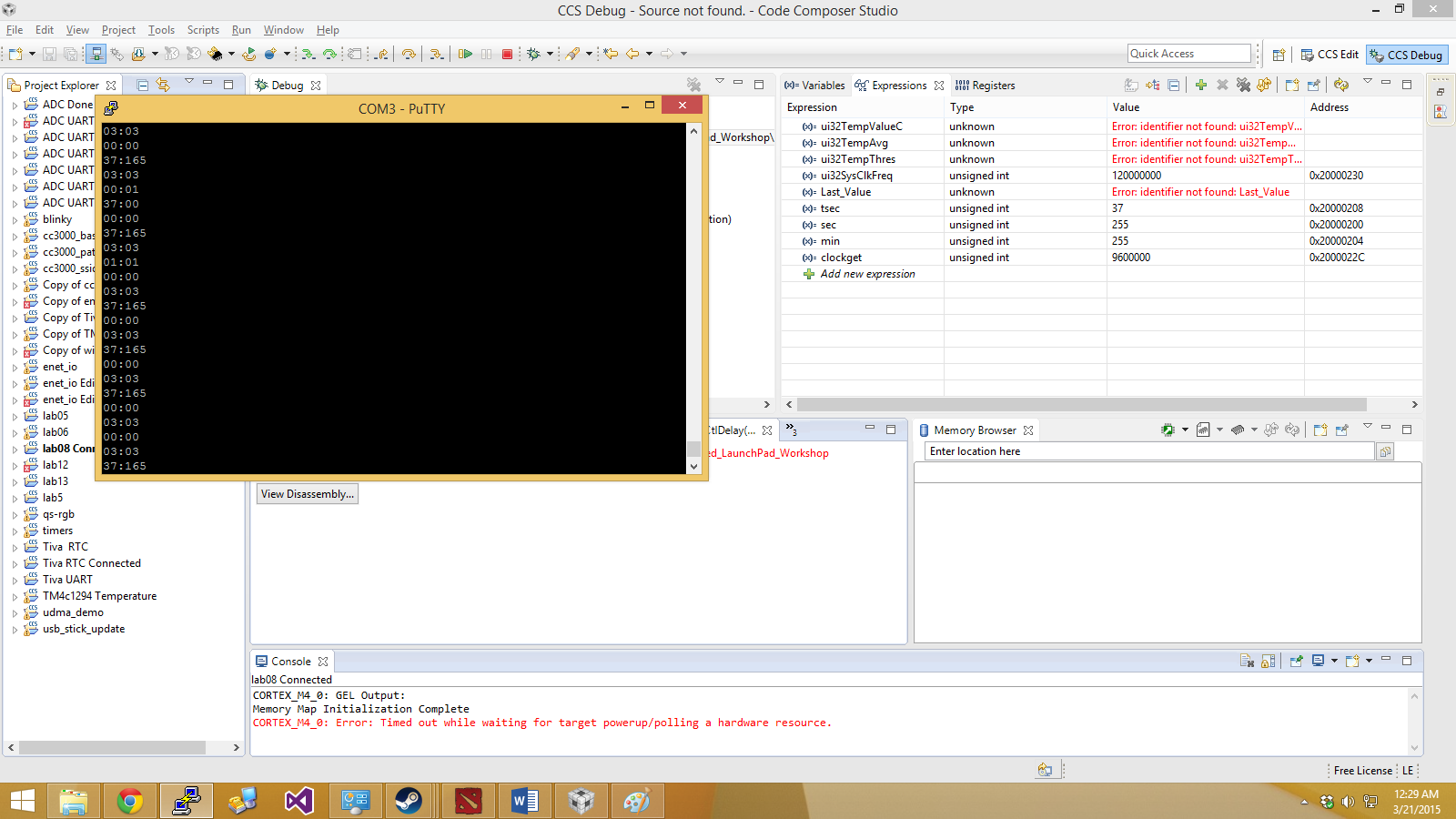

  • Hi Amit,
    When i Add the while(!(I2CMasterBusy(I2C0_BASE))); it gets suspended.
    Otherwise, the UART is a bunch of random numbers

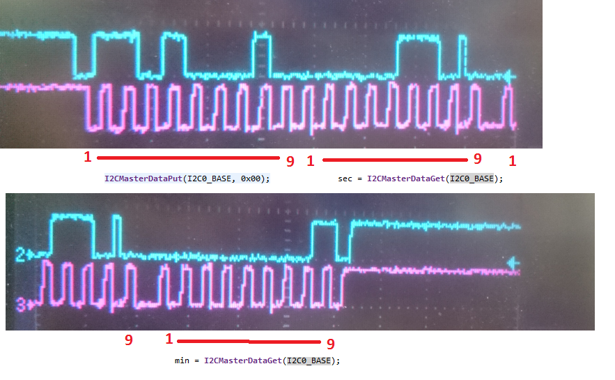

  • Like this
    I apologize for my lack of explanation.

  • Hello Jeunn,
    I was checking the waveform and as I see it, there is a NAK happening and still after that there is a byte being transmitted/received. Can you please confirm if that is a receive or transmit when the NAK happens and then 1's come on the bus?
    Amit

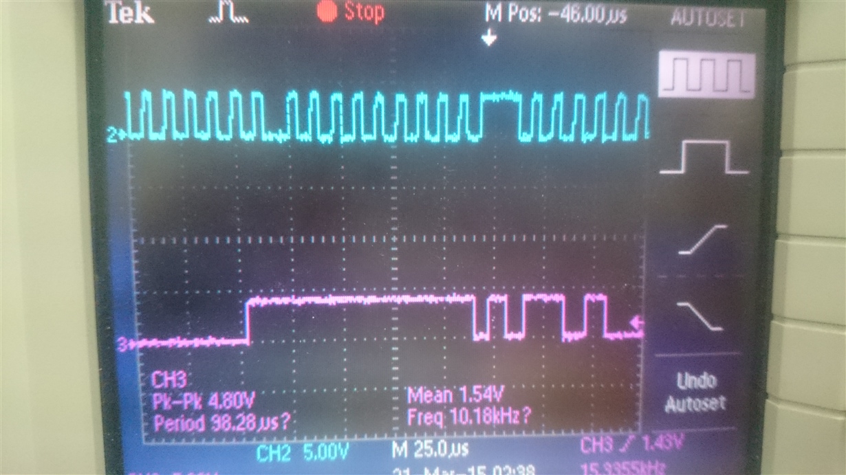

  • Hi Amit,
    Is it safe to say that it is a receive because this is the waveform captured as the master is reading from the slave (secs and mins).
    I apologize as my knowledge on this is extremely shallow..

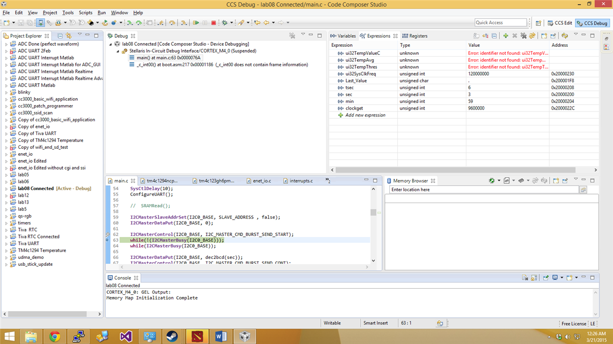

  • Hi Amit,
    Using breakpoint in the While loop to obtain the waveform, this is the data i get:
    Am i doing this correctly?
    Thanks for your kind patience..
    Jeunn Hao.
  • Hello Jeunn,
    Yes, you are doing the right thing.
    Amit

  • Hello Jeunn,
    Why is the code being commented.
    // while(!(I2CMasterBusy(I2C0_BASE)));
    Instead did you try putting a SysCtlDelay(3000);
    Also I would need the waveform at the time of failure. So if you know what the failure is going to be then capture the snapshot with a GPIO toggle, such that when the values are unexpected, it will get stuck in a while(1) loop and the last capture will persist. Also please make sure that the pull up strength is good and there are no glitches on the line.
    Amit

  • Hello Rohit,
    Did you compare the output from the DS1307 with the I2C waveform as captured on a scope or Logic Analyzer?
    Also I would advise you to search DS1307 as the keyword on the forum search to see similar attempts in the past have succeeded.
  • Dear Amit,
    My clock is counting and updating fine. Just the minute, day and month values are appearing absurd although internally the clock is working fine. I see absurd values for minute, day and month. Can you help me with this specific problem?
    Keyshav
  • Hello Rohit,
    Do you have a log of the values from the first time it is set in the RTC device followed by a subsequent read?
    Also without code and the capture of the I2C on the IO pins, it would not be possible for me to tell what is going wrong!!!
    That is why I suggested checking other example codes. Also do make sure that the DS1307 is correctly wired and using the correct clock.
