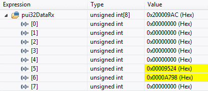

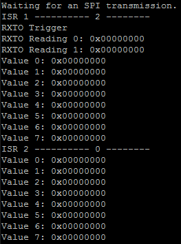

My problems/questions:
1. The ISR is only triggered on every fourth transmission from the BBB. From my understanding of the SSI FIFO, the SSI_RXFF condition should mean that the ISR is triggered after 8 bytes (one complete transmission of my 4 data words). Correct?
2. Once triggered, the contents of my variable pui32DataR do not contain the contents of the transmission (at least not as I intended). What I see is:
As I am new to C, I am hoping somebody can help point out my obvious mistakes and/or misunderstanding about retrieving this data. I'm looking to learn, but have so far not found anything online. Please help get me back on track. Thanks!
