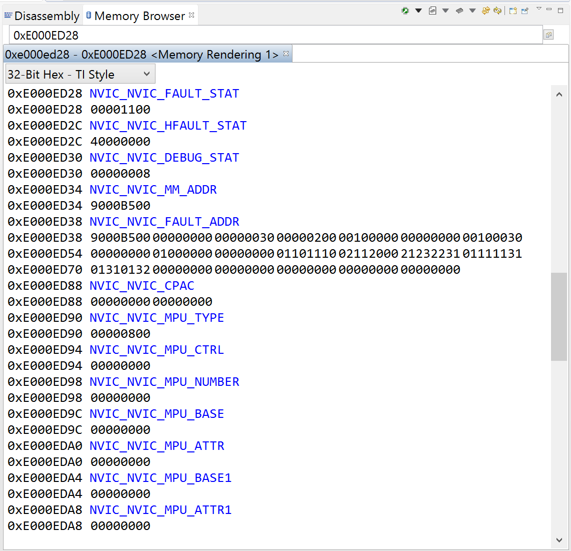

  • I attempted to debug the project, then pause it to halt the processor. When pausing, I receive the "Debug Port error occurred." message and do not see any values in the Registers tab.
    Additionally, I don't see the NVIC_FAULTSTAT register listed by default, do I need to add this manually?
    Either way, I see no values in any of the registers because of the error.
  • Hello Austin,
    The address are 0xE000ED28 and 0xE000ED38 and can be viewed in memory browser. What I am not sure is the "Debug Port Error Occurred". That would mean something went wrong in execution or a debug browser is pointing to a non-mapped location
    Amit
  • Hi Amit
    Here is an image of the memory at those locations. Yes, there are indeed bits set. However, I am not sure what NVIC indicates.
  • Hello Austin,
    The Error bits can be seen in the Section for Cortex M4 Peripherals of the data sheet. It basically indicates that the Instruction Bus has faulted. Now comes the tough part. You would need to isolate the faulting section of code in your program by setting breakpoints and using step debug, and then we can debug the dissasembly to see why the Instruction is not being fetched from the correct location.
