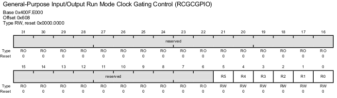

    The 32bit register for the TM4C123GH6PM part can be seen bellow (didn't find any TM4C1220X, are you sure you posted correctly?):
    The TM4C123GH6PM has until GPIOF, that's why there's 5 usable bits (A, B, C, D, E ,F). Other parts with more GPIO would have more usable bits.
    So this is the whole register, you can control all the GPIOs clocks (run or disable) at the same time. The macro SYSCTL_RCGCGPIO_R refers to the hole register. See why it isn't just for 1 bit (bit banded region)? It's general to a whole register. Hence why you need usually to use |= to set a single bit only or &=~ to clear a single bit.
    I know in Tivaware there are macros to help accessing a single bit but you can do that anyway with some operations. I do believe all registers macros refer to the the whole register (the bit-band alias region) though I never use direct register method with direct register programming like that in the Tiva.
