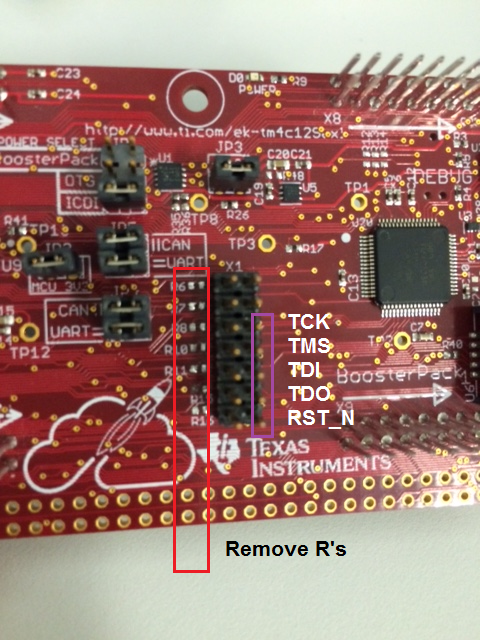

    I finally got my Evaluation Kit (EK) this weekend.
    I proceeded to remove all 8 resistors (6-8, 10, 11, 15, 18 and 40) called out in the SPMU365a.pdf document paragraph 2.3.1.  However, I now realize is that R40 is probably required in order for me to program the board as Code Composer fails to connect to the device with a debug session.

  • Hello Rafael,
    Attached is a snapshot of the board modification I have made. I have only removed the R6-8, 10, 11, 15 and 16 as shown in the red-box and then taken the JTAG/SWD from the purple marked side (after mounting a 2x7 header). No other change required.
    The code is not available but the seuqnence to unlock the part is available in the data sheet section for JTAG. I am not sure whith what was there on the custom board so really I would not comment on that. The resistances are all 0 Ohms, and so will be a shunt (almost 0).
    I am not sure why the WDOG enable would cause the device to go into such a loop unless the value programmed into it is very small causing the device to reset before a debug can be enabled.
    Amit

  • Hello Rafael
    No. The SWD-JTAG switch does not require a start bit. Did you remove any other resistor other than that mentioned in the picture. Also if you have the berg pin headers mounted, you can use a shunt to get back CC function on the ICDI. I do that all the time with my modified board (as shown in picture)
    Amit
