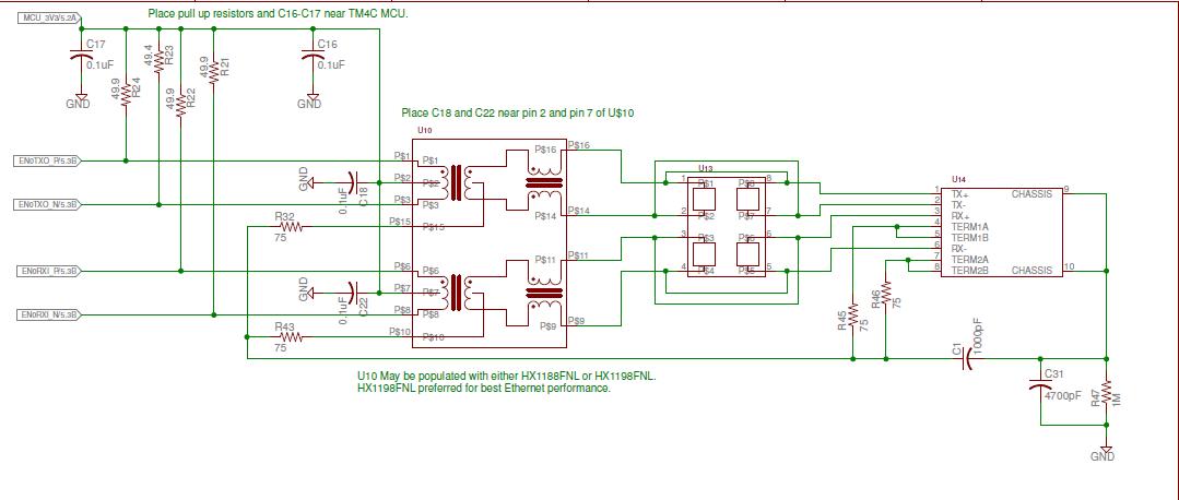

  • Hi Amit,
    Here is the schematic, and the schematic will be deleted as you read.
    Jin
  • Hello Jin,
    I went through the schematics and here are my observations
    1. Why is a 16MHz crystal connected to Hibernate? Hibernate crystal is 32768Hz (32KHz).
    The only reason I see for the Ethernet not to work is that the Y1=25MHz is not 25Mhz but some other frequency crystal. Can you measure the frequency of oscillation?
    Amit

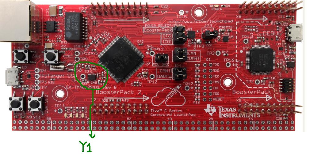

  • Hi Amit,
    I tried to measure the frequency of oscillator, but the chip is so tidy, and it is already mounted on the custom pcb.
    Even with TM4C board I am not sure how I can measure the frequency of OSC(Y1 below) directly?
    Jin
  • Hello Jin,
    You can measure the OSC0 at C44 on the LaunchPad. Another alternative would be to have a simple code to toggle a GPIO Pin in a while loop with System Clock Configured to 120MHz when running from PLL. Then flash the same code to your custom board and measure the GPIO toggle rate. If the main crystal is working correctly at 25MHz then it should be the same.

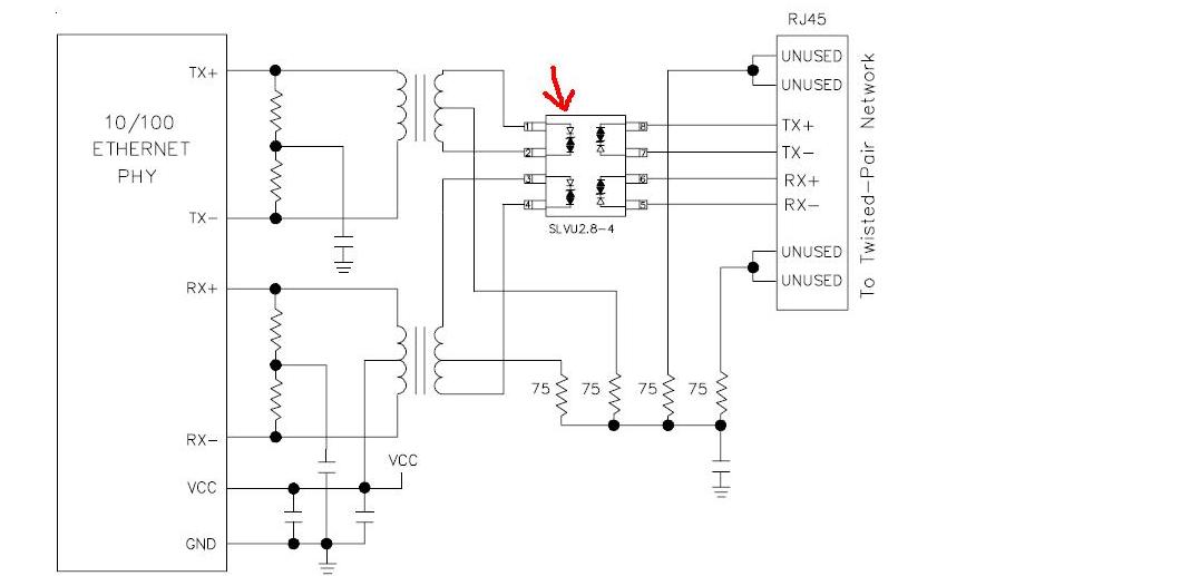

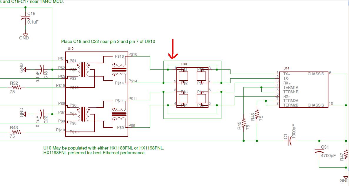

  • HI Amit,
    I wonder about the wiring configuration of the diode array between a transformer and RJ45.
    In TM4C1294XL user guide, Pin1/ 8 ,Pin2/7, Pin 3/6, and Pin4/5 are connected
    However, the datasheet(SLVU2.8-4) provided by SEMTECH does not seem like same as the above one.
    The custom board seems to not have the wiring connections in diode array shown on the TM4C user guide.
    Is it not really a matter? both are fine?
    Jin
  • Hello Jin,
    I think that is the issue. The Ethernet pins are getting stopped at the ESD protection.
    Amit
  • Hi Amit,
    The wiring configuration of ESD protection was wrong.
    I thank you for helping me out.
