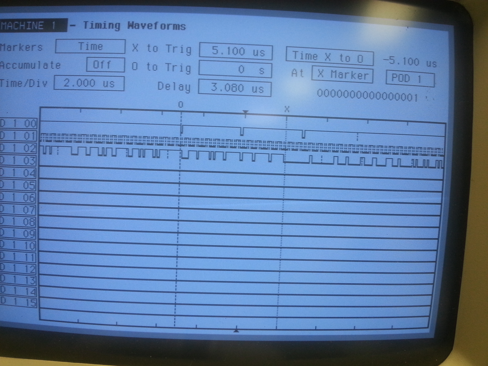

Why do I see four interrupts here?
Hi there,
I am using SSI/DMA for the first time and had some questions. I enabled two interrupts, RX/TX, so I expect two, but I saw four instead (No, it will not affect any operation):
Two before the end of the transfer, which is marked by X, two after
Could anyone be so kind to give me some pointers? Thanks!
Here is my SSI configuration:

  • Hello David,
    I believe it to be the SSI DMA DONE firing multiple times when done, till it is cleared by means of reenabling the channel.If you would move the SSIntClear to the last of the interrupt handler or handling the clear operation in it's if condition then it must not occur again,
    Amit
  • Another question regarding SSI/DMA:
    If I need to stop DMA at the end of transfer automatically (one-shot), how should I config the DMA channel? I tried a few modifications to the configuration and didn't find one that worked
  • Hello David,
    You would need to disable the DMA request from the SSI. This will prevent the SSI from generating any further DMA Requests.
    Amit

    Now, it interrupts at 1Mhz rate, basically drags the main to dead
    At this point, one can use disableint to pass it, but what are these interrupts ?

  • Hi Amit, I tried your suggestion.
    Yes, it will terminate the DMA, but when I tried to start another one-shot transfer, the data is totally messed up (the Tx and Rx are shorted in the experiment). Could you be so kind to point out my problem?

    From the logic analyzer, I see the the interrupts can occur in the middle of a transfer and in the middle of no transfer, meaning no SSI clock nor data around the event at all
    The print out of data are shown below: where the first one (Flag=48) is when the interrupt occurs when there is no SSI clock nor data around at all, and the second one is when the interrupt occurs in the middle of a transfer and it has data misalignment (see the first 0...7 then start over again)
    Flag=48 0 0 0 0 0 0 0 0 0 0 0 0 0 0 0 0 0 0 0 0 0 0 0 0 0 0 0 0 0 0 0 0 0 0 0 0 0 0 0 0 0 0 0 0 0 0 0 0 0 0 0 0 0 0 0 0 0 0 0 0 0 0 0 0 0 0 0 0 0 0 0 0 0 0 0 0 0 0 0 0 0 0 0 0 0 0 0 0 0 0 0 0 0 0 0 0 0 0 0 0 0 0 0 0 0 0 0 0 0 0 0 0 0 0 0 0 0 0 0 0 0 0 0 0 0 0 0 0 0 0 0 0 0 0 0 0 0 0 0 0 0 0 0 0 0 0 0 0 0 0 0 0 0 0 0 0 0 0 0 0 0 0 0 0 0 0 0 0 0 0 0 0 0 0 0 0 0 0 0 0 0 0 0 0 0 0 0 0 0 0 0 0 0 0 0 0 0 0 0 0 0 0 0 0 0 0 0 0 0 0 0 0 0 0 0 0 0 0 0 0 0 0 0 0 0 0 0 0 0 0 0 0 0 0 0 0 0 0 0 0 0 0 0 0 0 0 0 0 0 0 0 0 0 0 0 0
    Flag=16 0 1 2 3 4 5 6 7 0 1 2 3 4 5 6 7 8 9 10 11 12 13 14 15 16 17 18 19 20 21 22 23 24 25 26 27 28 29 30 31 32 33 34 35 36 37 38 39 40 41 42 43 44 45 46 47 48 49 50 51 52 53 54 55 56 57 58 59 60 61 62 63 64 65 66 67 68 69 70 71 72 73 74 75 76 77 78 79 80 81 82 83 84 85 86 87 88 89 90 91 92 93 94 95 96 97 98 99 100 101 102 103 104 105 106 107 108 109 110 111 112 113 114 115 116 117 118 119 120 121 122 123 124 125 126 127 128 129 130 131 132 133 134 135 136 137 138 139 140 141 142 143 144 145 146 147 148 149 150 151 152 153 154 155 156 157 158 159 160 161 162 163 164 165 166 167 168 169 170 171 172 173 174 175 176 177 178 179 180 181 182 183 184 185 186 187 188 189 190 191 192 193 194 195 196 197 198 199 200 201 202 203 204 205 206 207 208 209 210 211 212 213 214 215 216 217 218 219 220 221 222 223 224 225 226 227 228 229 230 231 232 233 234 235 236 237 238 239 240 241 242 243 244 245 246 247
