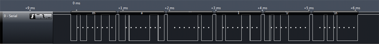

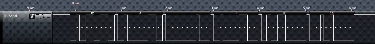

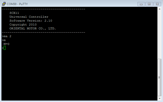

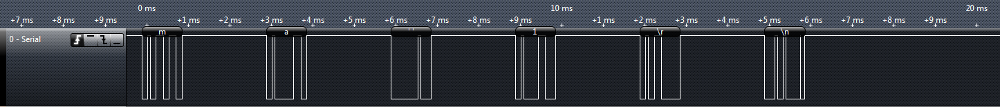

I looked into the terminal and see that the TIVA is only sending “m/r /n” instead of “ma 1/r/n”
See attached picture. First line is PC attempt, second line is TIVA attempt.
Looking through the forum posts I realized I may need delay/interrupt but I'm unsure if that is the cause of the problem
Any help appreciated
