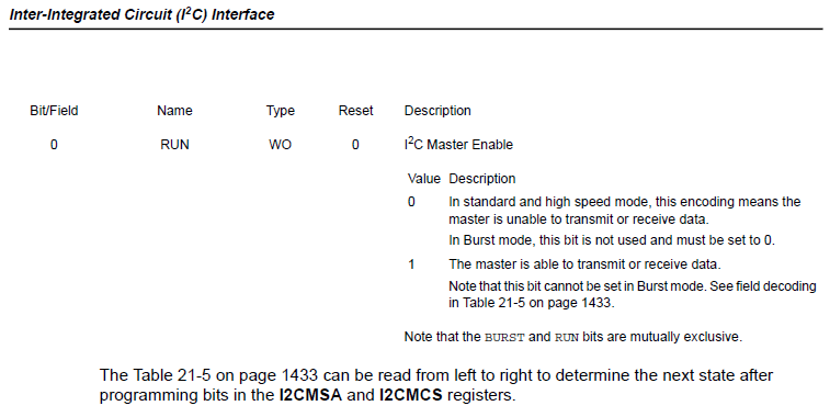

  • Gentlemen:
    I too am still having serious issues with the TM4C129X I2C communications as reported at:
    https://e2e.ti.com/support/microcontrollers/tiva_arm/f/908/p/343532/1500424
    Note in the “I got the solution!!!! :)” solution that there is apparently an ISR Handler which MUST call I2CMasterIntClear(I2C0_BASE);. Otherwise, that ISR will be constantly and repeatedly called till the line of code that follows is called in that supposed solution:
    I2CMasterIntClearEx(I2CBase, I2C_MASTER_INT_NACK|I2C_MASTER_INT_DATA);
    However, the required I2CMasterIntClear(I2C0_BASE); call in that ISR Handler will clear the I2C_MASTER_INT_DATA bit being examined in that supposed solution.
    I too would like a SIMPLE example of RELIABLE I2C code that actually works with no band-aid delays etcetera.
    Wasn’t the TM4C129X I2C communications thoroughly tested and verified before releasing it and the documentation to the public?
    By the way, in the TI Data Sheet, notice the statements that RUN is not to be set in BURST mode:
    However, the TivaWare defined constant I2C_MASTER_CMD_BURST_SEND_START sets the RUN bit (i.e. START and RUN).
    This is yet another example that the defined constant names in the TivaWare Peripheral Driver Library for the MCS register values are not intuitive but are misleading and confusing. One may be better off ignoring them.
    Yes, after digging deeper into the Data Sheet, I now understand that the Burst referred to must be related to the FIFO Burst mode.
