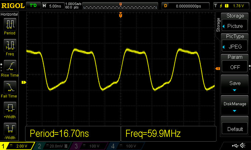

  • Since I had a 129 launchpad handy, I decided to see how fast an I/O will toggle. Here you go...
  • Might you describe how you configured the MCU to achieve this?
    Suspect this resulted from a Timer set to PWM mode at highest frequency - better if you'd describe. Thanks this effort.
  • My intent was to answer the OPs question without clouding the issue with a lot of technical detail. ;-)
    You are correct, this is done with a timer in PWM mode. Doesn't help much for serial communication.
    Randy
  • Thank you - appreciated.
    One wonders if that waveform could be improved via an increase in output current setting - or if that capability exists - when the MCU pin is configured as a Timer? So many vendors producing ARM MCUs - hard to keep straight - which MCU does what?...
  • The port pin is configured to use 12mA of current. The waveform distortion is due to the board layout.
    Randy
  • Looks like you've given the pin, "every chance." The "excess" rise-time (not so evident @ the fall) gives me pause to agree that this is solely "layout."
  • The rise and fall take place over a period of only two samples (it's sampling at a GHz and by eye the rise/fall is ~2nS). It would be more obvious with the interpolation turned off, one of the perils of DSOs.
    Randy, if you know, What's the 'scopes bandwidth at that time scale?
    You also do not need much inductance or capacitance at that edge frequency to give you a 2nS edge.
    Robert
  • The scope's bandwidth is around 130 to 140 MHz.
    This was measured on the header "X11", pins 4 and 6 on a "Connected Launchpad" and the traces go all over the place to get there.
    Randy
  • Thanks Randy, so around 10nS. The edge rates exceed the 'scopes bandwidth and are sufficient to provide the rise/fall times displayed. The layout probably doesn't help but I don't think you can be assured you are seeing the true edge response here.
    You may also need a good probe setup as well to get a better view.
    I wouldn't read anything into the rise/fall either.
    Robert
  • Understanding how to interpret your instruments and their limitations is all part of the game.
    I get that.
    The purpose of my post was to demonstrate that the port pin will toggle at 60MHz., nothing more.
    I have other scopes and probes here on the bench that can do a better job of representing the signal.
    The Rigol is an easy way to publish a screen shot.
    Randy
