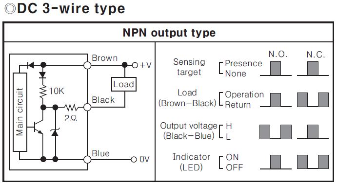

    The Proximity is a PR30-15DN proximity sensor used in an NPN configuration.
    www.farnell.com/.../1599273.pdf
    Look on page D-23 for the Part #.

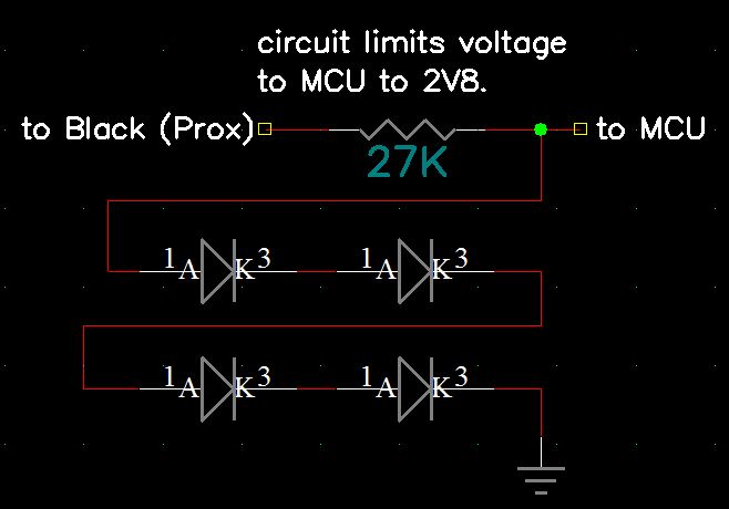

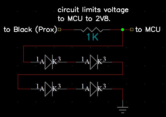

  • Thank you - appreciated - my suggestions follow:    (for clarity I present the key drawing - your device)
    I've tried now three times to add verbage to the above drawing - "Post" button spins & spins - never completes.   I've had to copy/past to salvage that writing - it appears next post....
  • Key to that drawing is the presence of the NPN transistor - which when switched on - and if the current through that transistor is w/in spec - will cause the Blue (0V) and Black (switched terminal) to come (nearly) to the same voltage potential. (less the drop thru that 2O resistor - imposed between the NPN's collector and the black terminal)
    That's "classic" NPN transistor use & application - so long as current (and voltage) are w/in the transistor's capability - all should be well. Note the "overlap" of the right-most signal graph - when your sensed target is present the "load voltage" (between brown-black) is greatest while the "output voltage" (between black-blue) is at minimum. Note too that the Led indicator is ON during that "overlap" condition - just described. (that's for the N.O. contacts)
    Now I don't believe that we (yet) have sufficient info to know the purpose nor utilization of your MCU. This proximity sensor - by itself - is quite capable of switching on/off a (proper) load - and indicating that upon its own Led. It is the presence of the target which causes this (desired) switching action - no MCU activity is required - at least that's unknown - at this stage.
    Should you wish to "monitor" the state of this prox switch w/your MCU - a (reasonably safe & simple means may be via the imposition of a voltage comparator - between the black wire/terminal and your MCU's selected input pin. I'd power that comparator from 3V3 - with a 10K pull up resistor at the comparator's output - which will make the signal levels "safe" for your MCU. The comparator may be wired to output either a "logic high (3V3) or logic low (near ground) based upon the voltage the comparator "sees" between "blue-black."
    If helpful I'll supply a schematic - its nearing 20:00 in US Midwest & I'm done - this day...

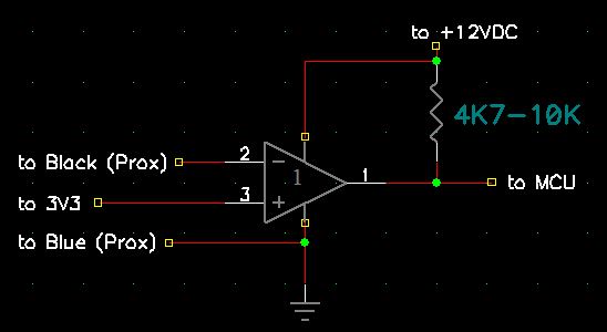

  • Here's a schematic - there are many ways to achieve your goal - this is just one.    Its merit is safety for your MCU - only 3V3 or ground will be presented to your MCU.   Comparators are available in many forms (some in duals/quads) this is just one example...   Note that the Prox ground - your 12V power supply ground and 3V3 ground all must be made common (tied together).   Only 3V3 powers the comparator - thus it should buffer/protect your MCU.
    In this implementation - when your Prox "turns on" (senses target) the black-blue voltage should approach ground - which causes the comparator's output to turn on - and provide 3V3 into your MCU.   (and that's current limited by the pull up resistor (shown).   When the target is "out of range/removed" the blue-black voltage should exceed 3V3 - and the comparator's output voltage will approach ground...
    Note: I've edited to change comparator's power to ~12V (to exceed any voltage applied to either input pin).    Such comparator - to protect the MCU should employ "Open Collector Outputs" so that the output voltage fed to the MCU is limited to the 3V3 (as shown) provided by the output's pull-up resistor.

    The comparator is good but a number of comparators will not withstand 12v on an input pin when supplied from 3V3. I wonder if a small relay with a 12V coil might be a better choice. Wire the relay coil as the load and the tips switch 3V3 inputs. If you want the prox to switch the motor as well a second relay wired in parallel would do that. Needs coil suppression but it is iinherently isolated. It may also be a better match to your ccurrent skill set. The comparator or an opto isolator might be a better volume choice but a relay is easier to wire.
    Robert
    You are (again) indeed, "Correct Sir."    Such was my screw-up during last night's rush.   To resolve I've edited the schematic to show the comparator powered from 12V (or the same voltage fed to the "top" prox. pin.)    To best protect the MCU I've specified an "open collector, output" style comparator - which greatly facilitates output voltage selection.   (the pull-up shown returns to 3V3 - perfectly mating to the MCU)
    Driving to work this morn I realized that either a low voltage zener diode (< 3V3) - or a series connection of several silicon diodes - either connected to that black prox lead or terminal - likely eliminates the need for the comparator.   Zener may prove risky - as most zeners do not exhibit a sharp voltage "knee" when the zener voltage is below 4V.   Four series connected silicon diodes w/current limiting resistor should protect the MCU while enabling adequate signal swing @ the MCU.

    Honestly, It’s really simple, first you should connect the DC/DC convertor, directly on the 12V source(although, you’re using a PC power supply, you already have a 3.3V source, thus you should not need the DC/DC convertor), from the DC/DC convertor(or PC supply 3.3V) supply your microcontroller and peripherals.
    Now to interface you’re proxy sensor, you have many options, one would be using an optocoupler, although this might look safe, but as your DC/DC convertor is not isolated(or if using the PC 3.3V supply), you’ll have to connect both grounds, as such, there goes the isolation…
    Let’s keep it simple, and use the resistor divider; your sensor has a 10K resistor connected internally in series with a diode to the positive supply, so a simple calculation(taking 0,5V into account for the diode, could be more/less) gives us a resistor with a value of ~4K, for a 3.3V output(you can use a 3K3 resistor which will give you a 2.8V output, which is high enough for a High level in the microcontroller).
    The only thing you need to do is to connect this resistor(say 3K3) on the sensors output(black) to ground, and connect the sensors output to your input of the microcontroller. If you want to keep it a little safe, you can add a Shottky diode on that output to your 3.3V supply(anode on output, cathode to the 3.3V supply).
    One thing not to forget, is that the microcontroller will see the switch ‘inverted’, thus when no metal is in front, the input will be high, and low with metal in front.
    You could also add a led on the sensors output to check its working, connect the led’s cathode on the output, and depending on which led you’re using(and how much current) calculate the series resistor, connect the anode to the resistor and from the resistor to the sensor supply.

    Note that a load is shown - imposed between "brown & black" - and if that load is even as high as 20K impedance or less - (not at all hard to imagine) the "too simple" voltage divide just suggested - will not adequately limit the voltage fed to the MCU - likely destroying it!    Not good - that!
    Earlier efforts here may have far better anticipated such (likely) occurrence.    Too quick/simple - while tempting - does have pitfalls...
