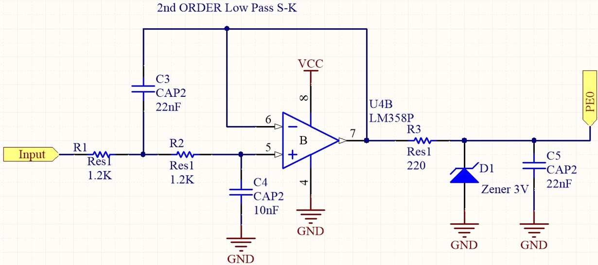

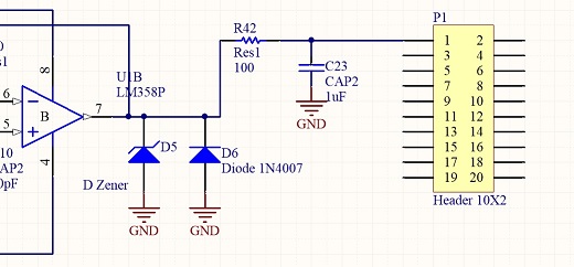

  • Martin Cunningham said:
    When I try placing a known voltage in one of the pins, the other ones (which aren't connected to anything) get affected as well.
    Just to be sure I understand.  The other pins are floating?  I.E. you have a voltage on one pin and the other pins are not connected to any voltage source or to ground?
    If so, that may be sufficient to explain your problem.  The inputs on an A/D system like on the TIVA are not fully independent.  They share sampling circuitry.  When the input is switched to a channel the source on that channel charges or discharges a sampling capacitor.  When it switches to a different channel the charge is retained and if there is nothing connected to that channel it will have essentially the same voltage as the previous channel. An oversimplification but maybe enough to get started with.
    That is why the A/Ds have a maximum source impedance specification. The source must be capable of charging and discharging that sample capacitor quickly. I typically use a capacitor on the input to provide a local low impedance source.
    As I did earlier for another poster, I would recommend that if you get a chance attend this vendor's (or another analog vendor's) seminar on data acquisition.
    Robert
  • As usual - poster Robert & this reporter are in agreement.    Always unwise to allow an MCU input (GPIO or Analog) to simply "float."
    As Robert outlined - that shared analog input cap requires great "care/handling" to function optimally.   And - we've noted - both this vendor & other ARMs - that often there's is, "signal bleed or crosstalk" especially so upon, "successive channels" w/in your "Step Configuration."
    You can reduce this signal bleed by employing the 8 step configuration - and always including a "dead channel" (yet not floating) - between each of your desired channel conversion steps.   (the significance of the 8 step configuration - assuming you measure 4 or fewer ADC channels - is the availability of an interposed "dead channel.")    The greater the difference between signal voltage - on consecutive step channels - the larger this "bleed impact."

  • Luis Afonso said:
    Would not the internal pull-up/down be enough for the (ADC) purpose
    Those pull-up/down are primarily employed when pin is "Digital" - don't believe they may be (effectively) enabled when pin is config'ed as ADC...
    And - they'd "color" your analog readings somewhat - would they not?
    If I understand correctly, this "dead channels" should be pulled down with an appropiate value resistor (I believe the eternally appealing 10k should do the trick, right?).
    I don't recall what chip you are using so check your documentation.  However, the one I am using specifies a maximum source impedance of 500 Ohms.  I would use a 100 Ohm or less pull down in that case.
    Robert
  • Even if enabled I doubt they'd be strong enough. Port pull-up/downs are designed for high impedance digital inputs.

  • Dear all,
      I've continued with this design. I'm finishing the hardware design stage. Following your recommendations, and reading the TM4C123 datasheet, I've added an Input RC circuit.  (Along with some clamping diodes to keep everything within the 0V - 3.3V range).
    According to datasheet, a source impedance of Zs=500 ohm allows for a T=250 nsec period.
    If I'm not mistaken, 100ohm-1uF should allow a  500 usec period, i.e a 2KHz sampling rate.  (Consdering a sample-time 5 times larger than the time-constant).
    I've got the following doubt. I'm triggering an ADC reading every 500 usecs. Each reading samples the 8 channels. Then I just take the values in channels 0, 3 and 7 (this is to avoid the signal "bleeding" between adjacent channels, as  cb1- kindly suggested).

  • That 1µF looks high to this reporter.
    Bit of indirection - exciting a "single" ADC channel with the (properly level set) "digital" output of a frequency generator - or from your MCU's GPIO (config'ed as output) can provide, "real-world measure" of your ADC's sampling speed!
    Toggle that GPIO - and when fed (routed) to a single ADC channel - with the 8-step configuration - you will note sequential ADC readings of, "full scale & near zero" when the frequency of that GPIO toggle "near equals" your ADC's conversion rate.     We have little interest in the precise ADC values - you simply want to establish that the ADC has "recognized" the difference - between the GPIO's digital, "low and high."
    Perhaps the simplest means to achieve fine (and wide) GPIO frequency control is via one of the MCU's Timers - configured into its PWM mode.    (this is the only way I know - to secure the "escape/output" - of a "direct" timer signal.)      Normally the external Timer pin serves as Timer Input only.
    We've long used this method - both during initial "test/verify" - and "downstream" - to best insure that what we "believe" to be happening has (some) basis in reality...
    I do not know the real speed with which the ADC takes the 8 readings. THIS should be the real speed I filter with my sampling cap- resistor. Correct?
    No.  Your R/C filter is a simple filter to remove or reduce frequencies about your sample rate (0.5 ms in your case). Strictly speaking if you you want to eliminate all frequencies above 1/2 your sample rate (See Nyquist frequency for further reading, you can get more subtle than that) but I've found a simple RC filter near the Nyquist frequency work well in many cases.  If your signal has a lot of frequencies near your sample rate you may want to revisit that assumption.
    For 2kHz sampling rate you would want a time constant of 0.5ms or longer. 1mS or longer may be preferable.
    You can add additional filtering internally to reduce the frequency further if your internal loop runs slower than your sample rate.
    If you do that, make sure the "bleed channels" are tied to a constant value via a low impedance.
    Check that you op-amp is stable driving that load.  100Ohms is probably sufficient to keep it stable but it's worth checking. Some op-amps will be noted as capable of driving a capacitive load.

  • I've continued working on this project, Thanks everyone for your collaboration, especially cb1- and Robert. You've been most helpful.
    One final doubt regarding the ADC's hardware.  I've added a 2nd order filter to my already-processed signal, with a cutoff frequency of approx 9kHz. (As I'm using a 2kHz sample rate in the ADC).
    Now, I've got some doubts regarding the use of the RC filter stage prior to the  ADC's input.
    If I'm not mistaken,  R3 and C5 (in my attached schematic) could be discarded, as it's redundant to re-filter what has already been filtered.  Is this correct?
    Or am I missing some considerations regarding 'input impedance' issues, or something like that?
    (As far as I can tell, the "source impedance" seen by the ADC is the output impedance of the filter's Op Amp , i.e an extremely low one)
    Thanks again for taking the time to read this.
    Kind regards.
    Martín
  • Hello Martin,
    The maximum source impedance as seen by the ADC pin the TM4C123 is 500Ohms. So from an impedance perspective the above circuit is OK. Removing the RC is not going to affect the signal quality unless a fast transient is expected from sources adjacent to the output of the OPAMP
    Indeed cb1 and Robert's inputs are very important on this forum. They do bring a lot of practical expertise beyond vendor.
    Amit
    Maybe, it depends on the op-amps capability of driving a capacitive load.  The drive must be fast and stable, capable of completely charging or discharging the sample capacitor in the sample time (I'd have to check the data sheet, it's probably on the order of 0.1 uS).  The capacitor C5 does this by effectively providing close to zero impedance to the sample cap/sample resistor combo and providing enough capacitance that the charge required to change the sample capacitor voltage does not change the voltage on C5 significantly.  The resistor R3 essentially decouple the op-amp from the capacitor, usually improving stability. Both R3 and C5 are cheap, I'd leave them in the design, you can always depopulate C5 and replace R3 with a zero ohm resistor.  Patching them in if you've left them out of the design is a lot more difficult.
    R3/C5 also act as a single order low pass.  Potentially useful.
    Finally you need to retain R3 in order for D1 to be useful.
    This filter should be much slower.  Less than 1kHz to meet Nyquist although you can fool around with it a bit in practice.  In general though 1kHz or slower is needed to ensure that the signal you read matches the input to reasonable fidelity.
    Robert
