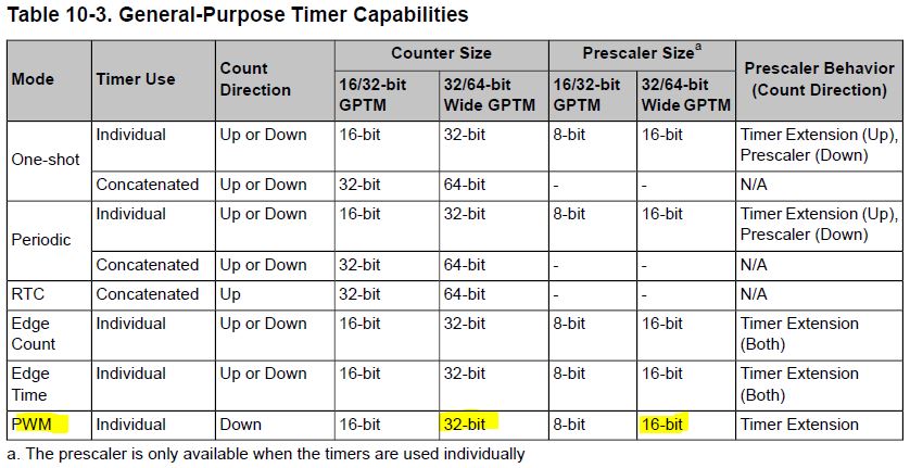

I am trying to configure 2 simple periodic timer but the more I read and the more I try different configuration, the more I get confused.
I tried 2 timers, 0 and 1 but get time intervals that do not correspond to the timer load values. I now have tried the WTIMER0 configuration  haphazardly because the documentation is scattered over a few chapters in DRIVER_LIB. Here is the code:

Time A interrupts at 1.305 seconds What am I missing? Is there a pre-scaler? Do I have to set the clock source?

    The Timers always have the system clock fed into them. What do you think is your processor speed set to?
  • The clock is set to 16Mhz:
    SysCtlClockSet(SYSCTL_SYSDIV_1 | SYSCTL_USE_PLL | SYSCTL_OSC_MAIN |SYSCTL_XTAL_16MHZ);
    Systick period set is 160000 giving a 1.28msec Systick measured with a scope on a toggled bit.
  • The clock is not set to 16MHz, it is set to 200MHz which won't work. Change SYSCTL_USE_PLL to SYSCTL_USE_OSC.
    Randy
  • I added a SysCtlClockGet() function to see the clock frequency the result is 12.5Mhz, so I tried to settings:
    SysCtlClockSet(SYSCTL_SYSDIV_1 | SYSCTL_USE_OSC | SYSCTL_OSC_MAIN |SYSCTL_XTAL_16MHZ); gives 16Mhz and
    SysCtlClockSet(SYSCTL_SYSDIV_1 | SYSCTL_USE_PLL | SYSCTL_OSC_MAIN |SYSCTL_XTAL_16MHZ); gives 12.5Mhz, the internal PIOSC.
    This explains Systick timing. But 16Mhz or 12.5Mhz still gives timing in the seconds range for TimerA .

    Not at all. The internal PIOSC is 16Mhz also. 12.5Mhz is the default configuration when using the PLL and not setting a division.
    You are using the PLL in your setting. The PLL generates a 400Mhz clock which later is divided by 2 making it 200Mhz.
    The parameter SYSCTL_SYSDIV_1 sets the division after the PLL. Hence 200Mhz/1 gives you 200Mhz, an overclock.
    It seems the function didn't allow the clock to be set, and left it at the default 12.5Mhz, because as far as I know the only hardware fail safe would set the system clock to the PIOSC (and could cause reset). Anyhow I think it's simply and error, anything can happen when you overclock the processor.
    Check more in 5.2.5 Clock Control on your datasheet.

    And to Luis - does this vendor's "Wide Timer" - when in PWM mode - (then) enable 32 bit PWM resolution?    (I recall 16 bit as the (usual) Timer-PWM limit)
  • Hi cb1,
    The timer does indeed allow for 32bit PWM resolution. At least it allows for 32bit numbers. Now if it's actually capable of giving that output I don't know. I haven't tested.
    Once to control a servo I used a wide timer instead of a timer+prescaler. At 80Mhz, to give the 50hz signal to a analog servo the load value would need to be about 1538461, hence why I used the wide timer (didn't feel like using a prescaler).
    And friend Luis - you are right - once again.    Here - from the TM4C123 data manual:   (note that the non-wide timers - even though 32 bit capable (in one-shot. periodic or RTC modes) - are confined to just 16 bits when ordered into PWM mode.    That's what I recalled - and why I asked...)    Thanks.
  • Digging a little deeper reveals that the non-wide timer running in 16-bit PWM mode also has 8 more bits of extension available yielding 24-bit resolution.
    This requires loading the timer match as well as the prescale match registers to control the PWM.  This can be tricky if the PWM needs to be updated on the fly as writes to these registers is not easy to do atomically.
    (The same holds true for the 32-bit wide timer PWMs)
    Randy
